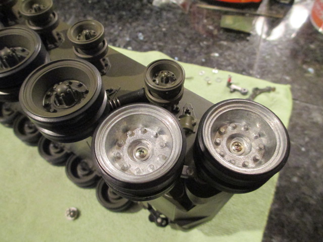

Installed metal suspensions and idlers and road wheels with bearings.  These came with the caps, one of which can be blurrily made out sitting by the hull on the green cloth.

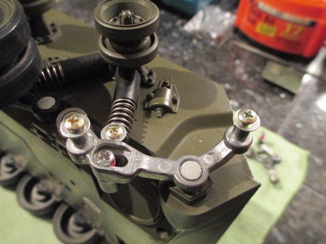

Metal suspension arms installed using the original push rivets and suspension springs.  New screw mounts replaced the original rivet on the connector.

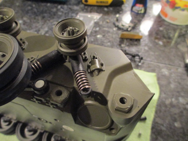

The calm after the storm.  Ready for the new parts.

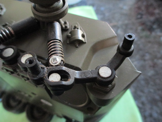

With a hardness like unto that of forged steel, these age hardened plastic suspension arms were very difficult to remove without damaging the rest of the lower hull.
With a hardness like unto that of forged steel, these age hardened plastic suspension arms were very difficult to remove without damaging the rest of the lower hull..JPG (95.7 KiB) Viewed 1159 times

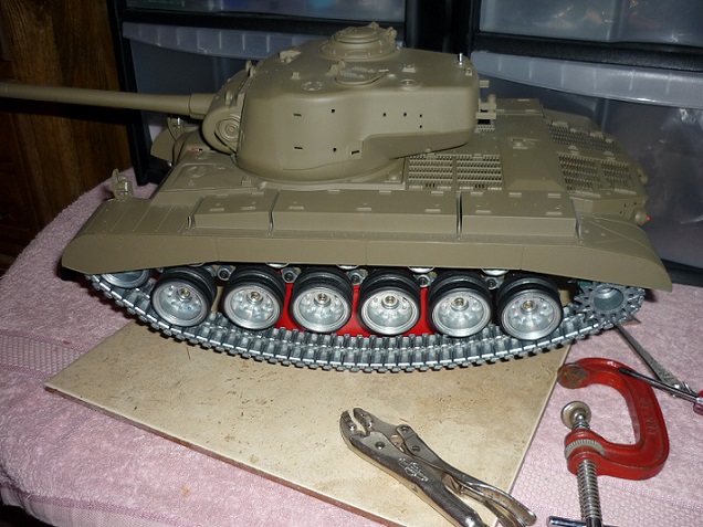

Like these

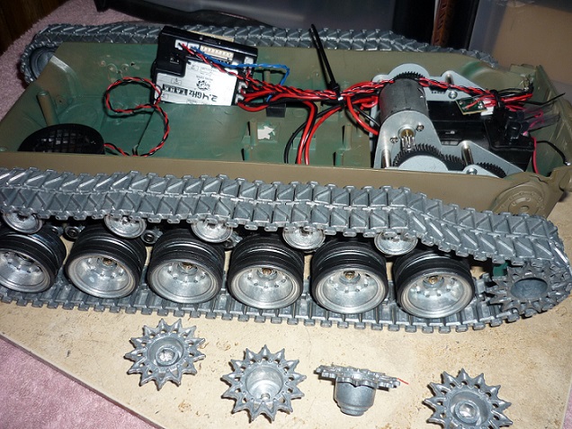

Re: Pershing metal roadwheels - Anyone tried it?
The sprockets in the foreground are heng long and they are utter crap, they are that out of round you could see the
tracks tightening and loosening as they turned.
FORGEBEAR TO THE RESCUE with a set of taigen sprockets which are much better.
I have also added 1 track link, I couldn't believe the difference that 1 link would make, before they were tight and it
didn't allow the front suspension to work properly, they may look loose but it runs great now.
The suspension arms are held on with the original screws from the plastic arms, its not the best set up as when fully
tightened there is a lot of slop, tried to shim it but then they lock up, I might drill the screw holes through and fit
a sleeve and fasten the arms on with a set screw and locknut.
