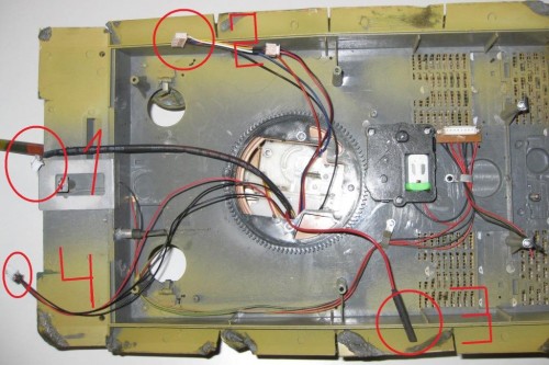

hi
number 1 this lead fits in CN2
number 2 this lead fits in CN3
number 3 this lead IS THE BIG RED ONE SOLDER TO BLACK NEG ON THE ON OFF SWITCH
number 4 this lead is the 3 wire elevation motor control in older tanks this is on the small square board
taigen top ir.JPG (53.86 KiB) Viewed 3298 times
in the new tanks its the black 3 pin plug next to the 8 pin
