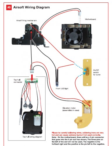

Before I admit defeat I thought I’d ask an expert to why the airsoft gun isn’t working. It’s got a rx 18 unit with sound (I’ve since replaced this in the hope that was the issue) I’ve taken the turret apart and powered up the gun with my bench power supply. And everything works as it should. There doesn’t seem to be a voltage coming from the rx 18 though when I metered it out I’m starting to give up with it. Please help.

There's a red on on/off (safety) switch in the airsoft circuitry. Usually, it's located in the cupola, but can be elsewhere. Have you checked to see whether it's on? Sometimes the most obvious solution is the hardest to see.
Here's the wiring diagram for airsoft (Taigen in this instance), but the guns are pretty identical.
