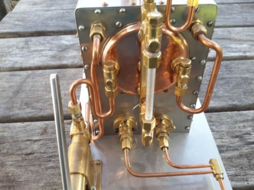

Visiting a model boat show I could not help but notice a couple of steam powered tugs. It really inspired me from the engineering point of view and as a challenging project to build my own steam engine that could be installed in a model ship. After surging through some old engineering magazines I found a four cylinder oscillating marine engine that looked so interesting. It was designed by a fellow called Jan Gunnarson
Here are some pictures of it.
walter
Posts: 567
Location: Geelong Australia
Re: Oscillating marine steam engines
Post by walter »
Front view
Front view

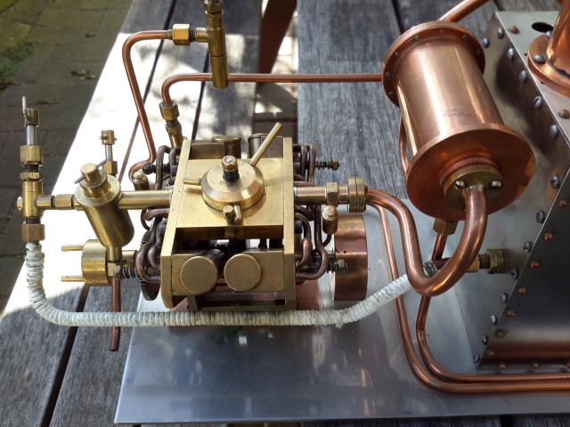

Post by walter »
rear of engine
rear of engine

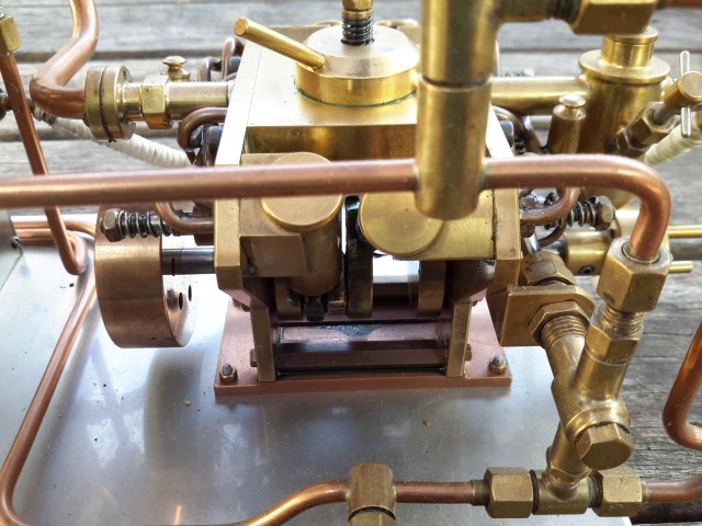

Post by walter »
Side view
Side view

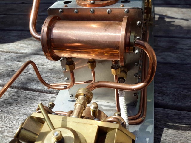

Post by walter »
Another side view
Another side view

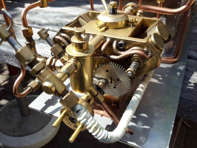

Post by walter »
And another one
And another one
