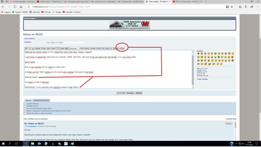

Best to use youtube and ore vimeo for video Clips
and then use the 'VIDEO' button up in R corner when making a New post in the tread
and insert url link in between
