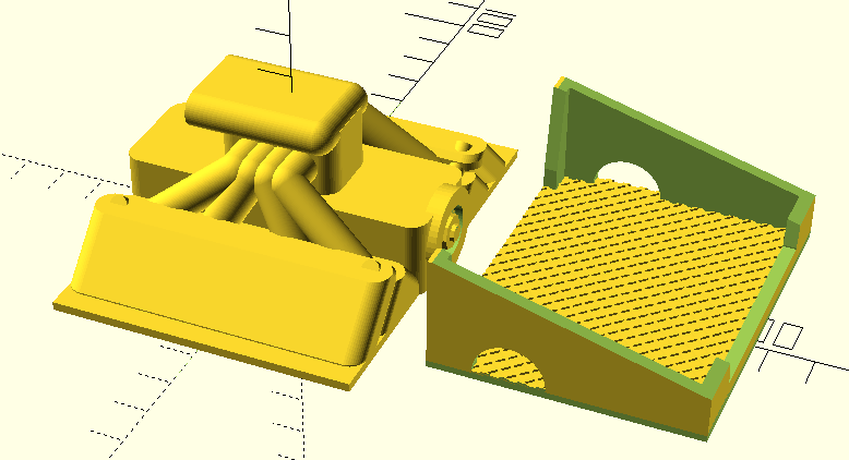

The crawler is on my bench, but the white filament that I ordered to print a new shell hasn't arrived yet, so I set about adding a bit of detail to the original bodyshell.
The interior, drivers and rear deck are all a one piece injection moulded sheet. which look a bit 'blobby'. I decided to cut the engine out, paint the the drivers jackets, and re-do the engine and deck.
Then it was just print it, paint it, and attach it all. Looks a bit better now.
mauler deck.png (32.7 KiB) Viewed 7403 times
