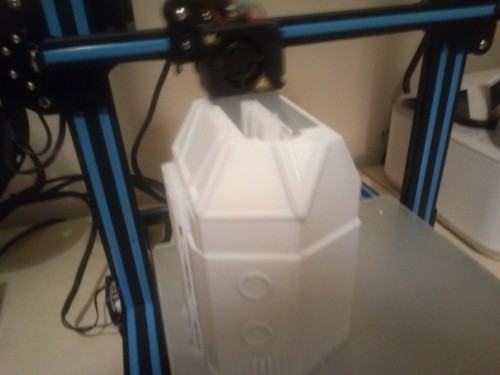

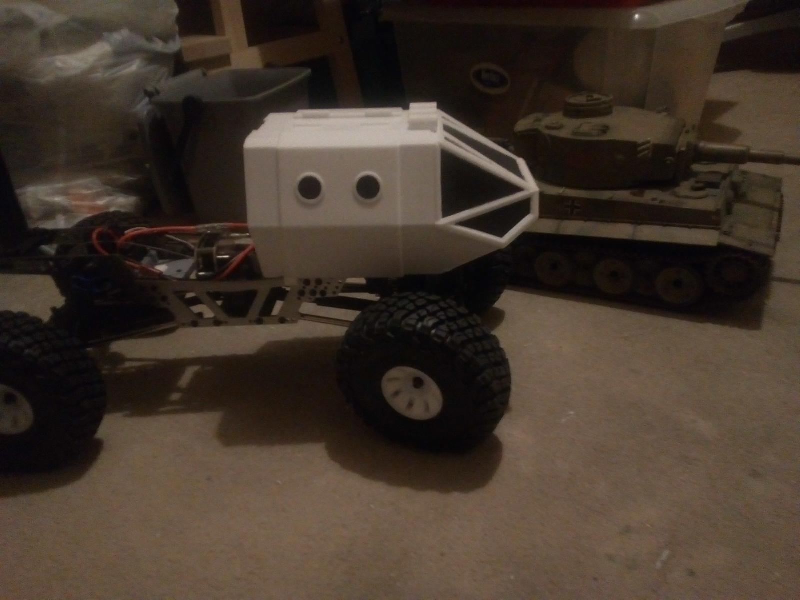

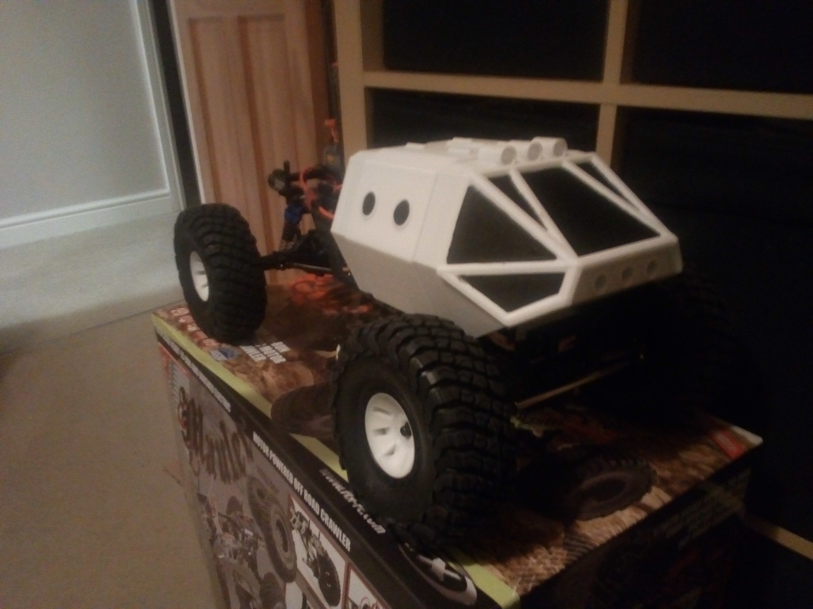

Post by wibblywobbly »
You have the settings wrong somewhere, Cura V3 is absolutely as good as it gets. The Mars Explorer is 1/10 scale and huge, almost as big as a tank hull. 42 hours for the cab print and it is flawless, all one piece, all mouldings incorporated, and all the support material just peeled straight off without a blemish.
