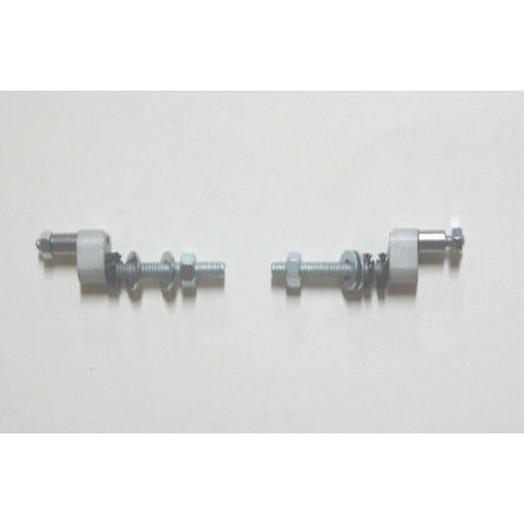

Arnie should know, Shaun, as he was an early recipient of Taigen's revised metal version. I'd guess that adjustment is made pretty much in the way it is on the Tamiya and Asiatam versions. The arm of the idler's tensioner has a few raised ridges/teeth at intervals (15 deg or so, I'd guess) that engage with slots/grooves cut in the retaining hub. It's a sort of (variable) locking key in a shaft arrangement. They're secured, in turn, by locknuts, or nyloc nuts, on the inboard side of the retaining hub. It's fairly basic, and doesn't allow for fine tuning; but it's better than nothing. I think
Spares are offered by rctank.de : https://www.rctank.de/PANZER-IV-METAL-TRACK-TENSIONERS
An interesting alternative product here: available from:
https://tank-modellbau.de/eng_244/Panze ... _tensioner
I guess an internal bespoke system is not really practical, as the Pz IV's actual arrangement is mounted on the exterior of the vehicle. Thus, I guess the point is, the 'authenticity' factor would likely affect any revolutionary redesign plan. .

Hi Roy I have already done the mod on all my existing PZ4s to great effect,
But I was looking at the available pictures and the literature and it looks like you would have to cut off a section of the retaining stub to fit an aftermarket Tensioner which if it is true makes yet another PZ4 Metal Hull u/s unless you care to start sawing lumps off it,
So shall I buy Taigens PZ4 metal hull and be the proud possessor of two next to useless PZ4 Metal hulls or just cut my losses and live with the Asiatam disaster I have already ?
Shaun.

Re: PZ4 Track tensioners.
If you want a Pz IV metal hull, I would go for Asiatams.
The new one from Taigen is more or less impossible to mod. Its a one piece full cast, so its a pain to get Track ajustment fitted and next to impossible to install drive shaft supports.
Asiatam is a lot easier to work with!
Btw, the Track tensioners that Rctank.de has in stock are the Asiatam ones and NOT the ones pictured!
