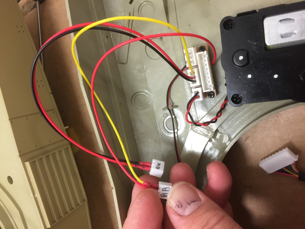

C. Rainford
here is how I wired up the AS unit
as it comes

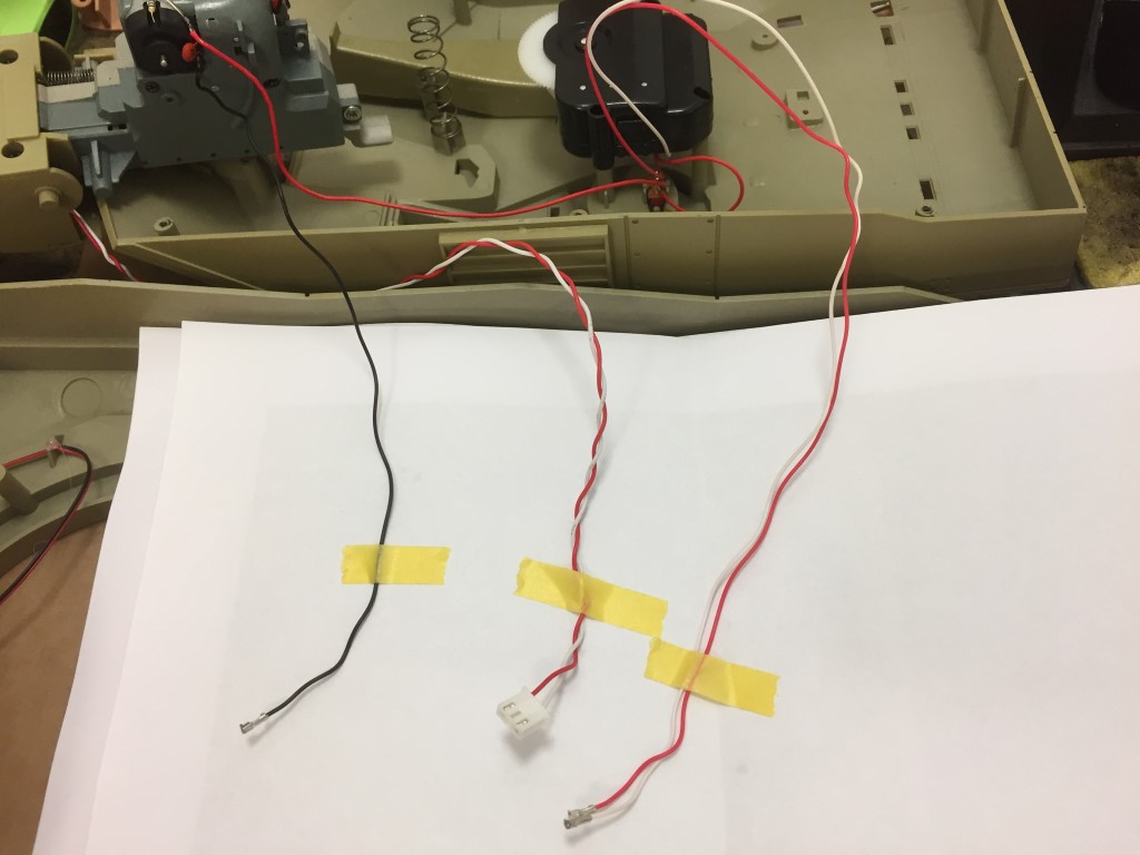

splitting

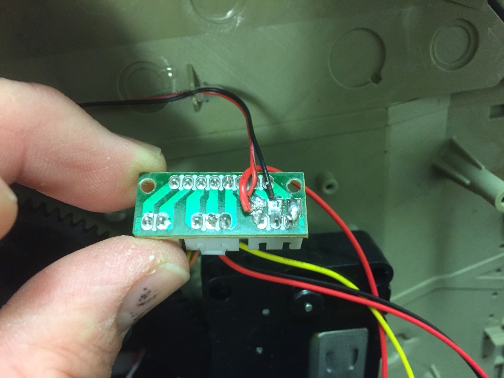

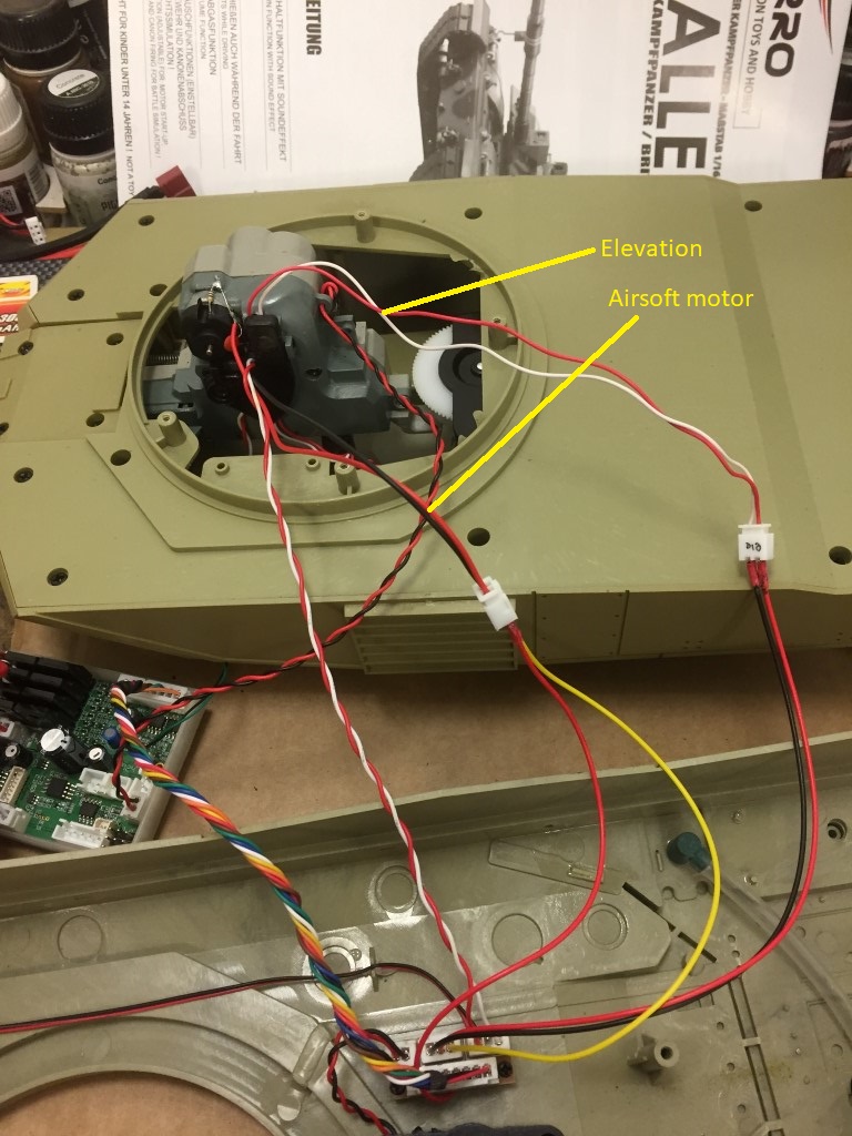

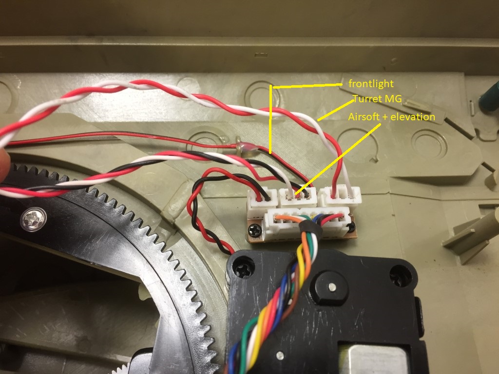

I Soldered a New wire from AS motor to Connect With the splittet one from 9pin Board
Set tk Board in HL Airsoft mode . Connect AS swich wire to :
CN3,Pin4:HL AirSoft Unit Switch
CN3,Pin5:HL AirSoft Unit Switch
And ahoy
