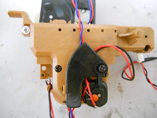

What voltage does the small black cased motor need to operate:
Airsoft motor voltage.jpg (23.56 KiB) Viewed 5750 times

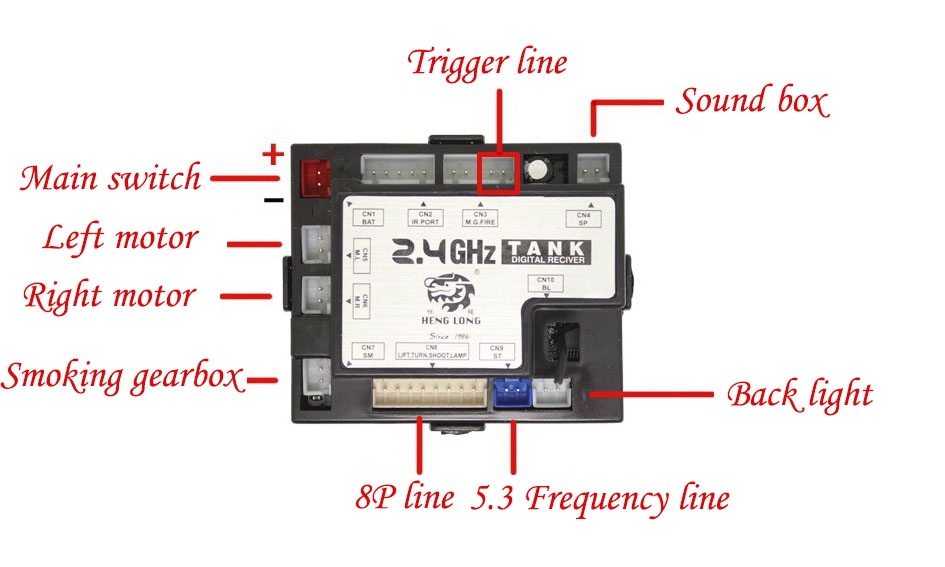

Any idea what pins would supply the voltage on a Rev5.3 receiver?
I'm upgrading an older 27Mhz MKIV F2. Everything's working now except the actual shooting of the BBs, even get that (blasted) chassis recoil effect :eh:
I've got the motor leads going to the pins (Trigger Line) as shown in this photo (found online):
But that isn't working.

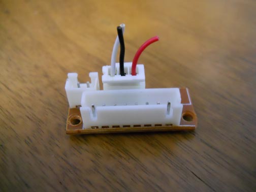

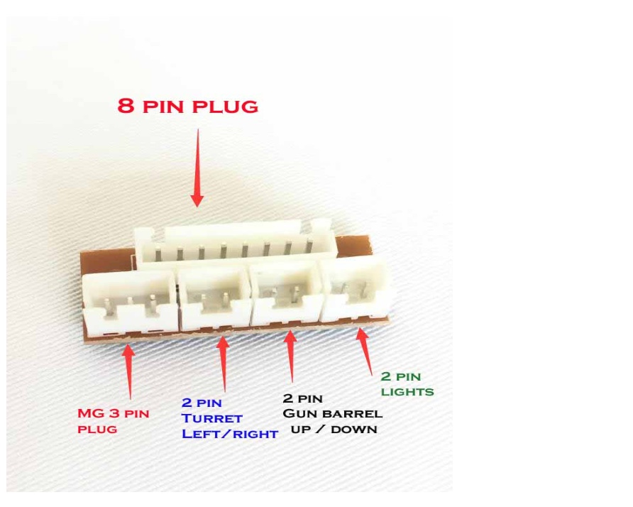

What have you got plugged into the 8 pin connector board on the hull ceiling.
The one in my tiger looks like this.
The blue and red wires on the left , and the black and red wires coming from the plug on the right connect to the motor on the bb unit. The wire coming from the back of the bb unit plug into the trigger line port on the main controll board.
I hope this helps, but if you need more clarification just ask.

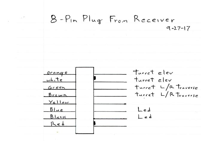

Here's the diagram of the 8-pin plug going from the receiver to the turret:
8-pin connector 9-27-17.jpg (24.15 KiB) Viewed 5709 times
As you can see, there's nothing currently going to the yellow pin. I currently have the 2 wires coming from the gun motor going to the Trigger Line on the receiver.
I'm almost positive I should have something going to the yellow pin, maybe jumper to one of the motor wires???

I try not to reference wire colors, because I've seen a lot of diagrams online that don't follow a pattern. Pin to pin is best but sometimes colors do help.
The 8-pin plug in the diagram above was connected to the 8-pin hull connector in other post above, the other ends of the wires were soldered to the old 27Mhz main board.

The new 5.3 setup with the much vaunted ' 2 sounds', requires this connector:
New Heng Long 8/9 pin connector
This separates all the main turret functions out, so that elevation is now independent of airsoft (and vice versa). In this arrangement, the signal path for the Gun to fire BBs runs through the 8 pin section of the connector block. On some models, the three 3-pin connector socket for the gun was on the same little PCB as the 8-pin socket. With the new configuration, it isn't. The trick is to trace all the three wires on the gun from point (Gun motor) to point (MFU). Having not seen the wiring arrangement on the T90 and other models using the 5.3 setup, it's hard to say how they connect the gun up. Clearly, there's no three pin connector from the Gun motor..as there's no provision for it on the connector block. I imagine then that the wires must be soldered to the back of the 8-pin terminal, or there's an extra electronic union somewhere. In any event, all you have to do is find a way for the gun to connect the the MFU. The two wire trigger switch only initiates the sound of the gun and the track recoil, and connects as per your diagram directly to the MFU- so ignore that; the airsoft motor, however, is also connected to an on/off switch in the Turret- for safety reasons. There's a modification described by Erik at 'Taigentanks' (Youtube), whereby elevation and airsoft are separated for use with the Clark Tk22 board. This is similar to the method used in Heng Long's upgrade, and circumvents the annoying cycling of the gun elevation. There's no real need for the switch, but if it's OFF your airsoft is not going to fire.... :problem: Have you checked?

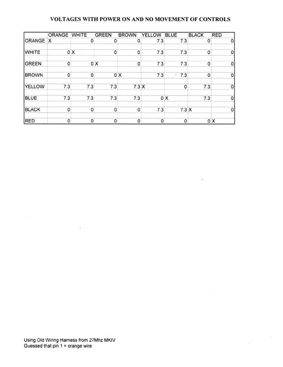

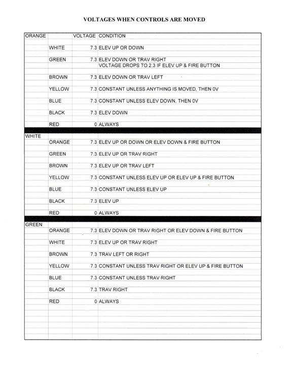

I opened the MKIV again this morning and took some readings. For those interested I made a couple of charts. Remember I'm using the 8-pin harness from the old 27Mhz unit. These readings are for turret voltages only.
First chart shows what voltages I read with power on and no movement of controls. I "assumed" the orange wire (look at the image in my last post) was pin #1:
VOLTAGE WITH POWER ON AND NO MOVEMENT OF CONTROLS reduced.jpg (27.48 KiB) Viewed 5677 times

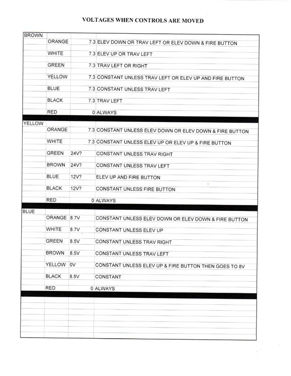

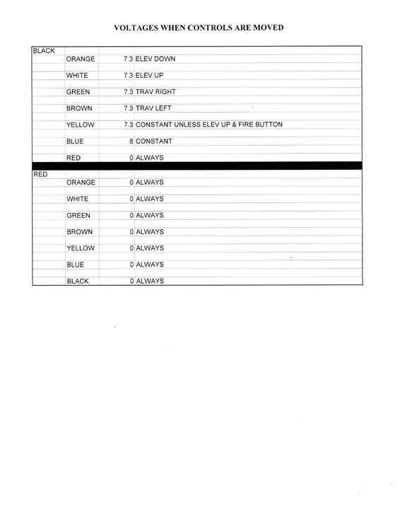

Next I took readings from each wire to all the other wires going to the turret, while moving each turret control (3 sheets are attached):
VOLTAGE WHEN CONTROLS ARE MOVED PAGE 1 reduced.jpg (59.72 KiB) Viewed 5677 times
VOLTAGE WHEN CONTROLS ARE MOVED PAGE 2 reduced.jpg (63.54 KiB) Viewed 5677 times
VOLTAGE WHEN CONTROLS ARE MOVED PAGE 3 reduced.jpg (31.68 KiB) Viewed 5677 times
Looking at the 8-pin chart from my previous post, I used orange and white to provide current to turret elevation. The chart "Voltages When Controls Are Moved" shows 7.3v when both these wires are used.
Looking at the 8-pin chart, I used green and brown to provide current to turret traverse. The chart shows 7.3v when both these wires are used.
Looking at the 8-pin chart, I used blue and black to provide current to the front hull LEDs. The chart shows 8v or so when both these wires are used. Surprised it's that high (maybe that's why they're so bright :haha: ) because usually they only need 3.5v (I checked this with a battery I have).
Again, all functions seem to work, except the actual firing of the gun. From the charts, the only wire combination I see that will fire the gun like it's suppose to is if I connect the blue wire and the yellow wire (from the 8-pin connector) to the airsoft motor. Voltage remains 0 unless I move the elevation up and press the fire button, then it goes to 8v.
Take a look and let me know if I'm seeing things or if any of this makes sense.
