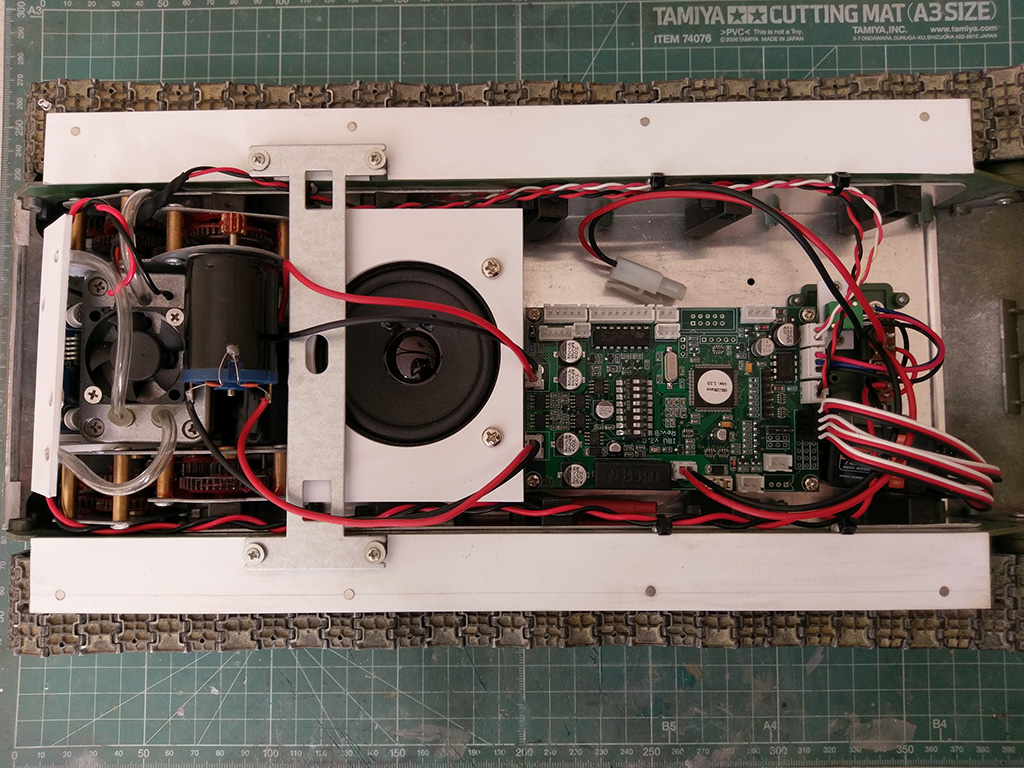

This is how I had my Taigen T-34 hull set up when I was running an IBU2:
By squeezing the Tarr in between the gearboxes, there's enough room for a big Visaton FRS7, IBU2 and a 2200 mAh LiPo. I removed the quick-release mechanism and replaced it with magnets, though. If you kept it as-is you'd probably need to fit a smaller speaker, but that would also make it easier to do servo turret traverse.

Raminator wrote:This is how I had my Taigen T-34 hull set up when I was running an IBU2:

bfrank1982 wrote:[And good idea with the magnets?
Wich type and size did you use? Neodynium?
And how did you fixate them in the underside of the upper Hull? By glue or skrews?
They're embedded in the upper hull; I'm using the Trumpeter T-34/76 kit which doesn't have screw mounts. Shaun's suggestion of using countersunk screws would work best with the Taigen upper.
