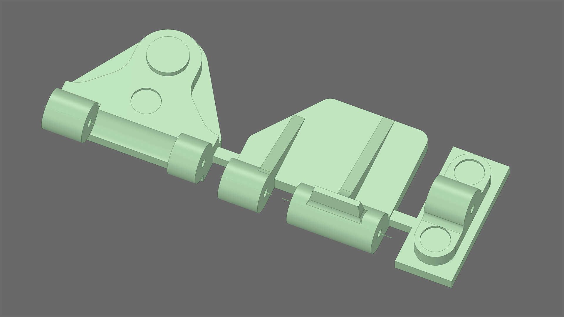

Here's what I've come up with over the last two days.
Some of the large hinges for the SU-152; one each on the gunner's and commander's hatches, and two each for the two halves of the loader's hatch:

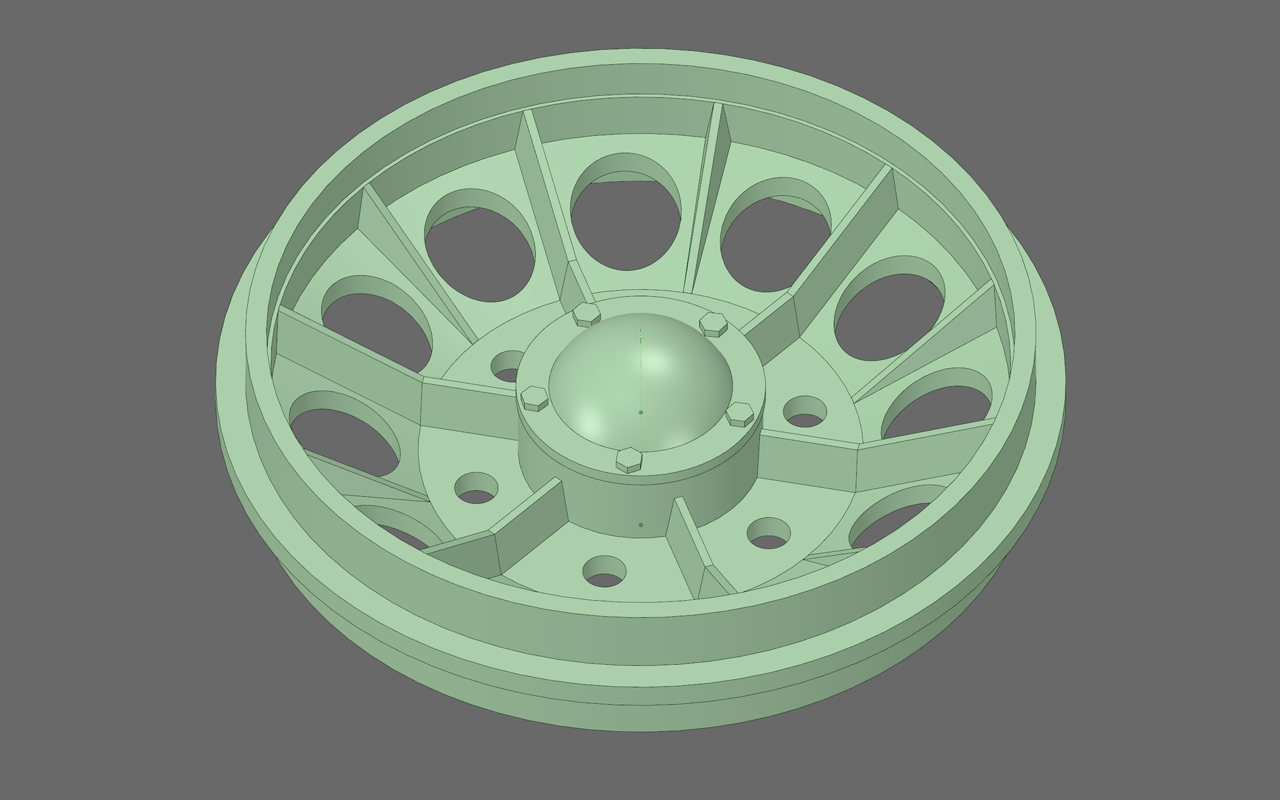

Half-spider roadwheels for the T-34 (the full-spider wheels were introduced in 1944, so my T-34/76 should have these as it's a 1943 production):

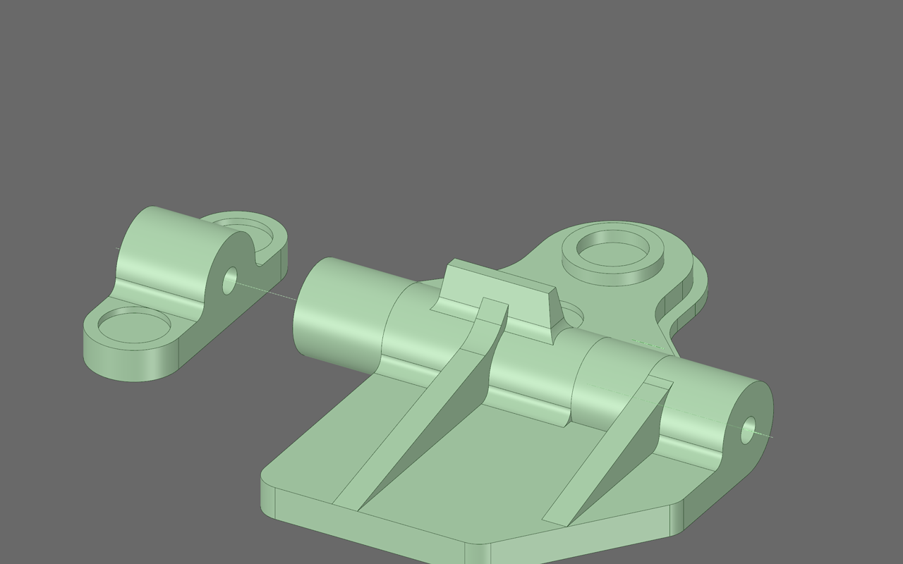

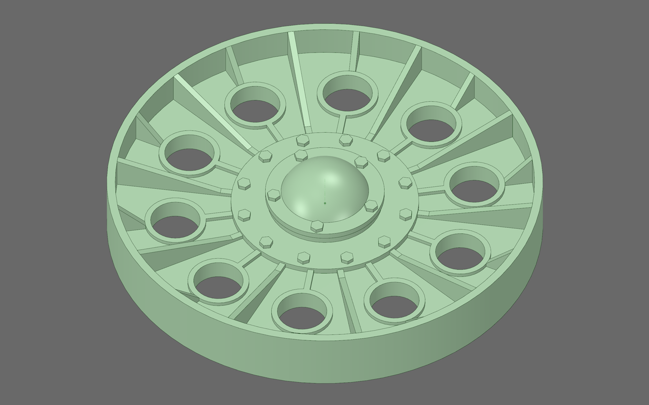

Looks good. If you can print those, you will have a whole raft of bits you could tackle.

Nice work. I'm just learning the sketch tools for the full version of DesignSpark (having been avoiding it for a few years - it's based on SpaceClaim). Hopefully the sketcher will see some significant upgrades in the new year.
Do you have the faceting toolkit on that version? This means you can improve the resolution where you need it.

Thanks for the kind words, guys. I've quite enjoyed playing around with DesignSpark and getting a feel for the different tools they let you play with.
Yes, you can set the faceting in the version I'm using Rob. I've set the values to half of what they use in the "fine" preset, and the .STLs look nice and smooth in Cura.RobW wrote:Do you have the faceting toolkit on that version? This means you can improve the resolution where you need it.
Cheers for the tips Woz, much appreciated. For reference, the ribs on the hinges are 1 mm thick, the spokes on the steel wheels are 0.8 mm thick, and the spokes on the half-spider wheels are 1.5 mm wide at the base. Would the frosted detail plastic be strong enough for functional hinges, do you think? The curved part is 3.5 mm in diameter, and should take a 2 mm axle through the centre.Woz wrote:Due to the limitations of printing you don't want to get too bogged down with the detail.

A 2mm hole through a 3.5mm part means it's only going to be 0.75mm thick which'll be very weak. I use paperclips which are 0.8mm in diameter. The plus side of using paperclips is that the ends of the clips are smooth which goes into the hole easier and the end you cut usually gets flattened by the cutters and when pushed into the hinge helps keep it in place.Raminator wrote: Cheers for the tips Woz, much appreciated. For reference, the ribs on the hinges are 1 mm thick, the spokes on the steel wheels are 0.8 mm thick, and the spokes on the half-spider wheels are 1.5 mm wide at the base. Would the frosted detail plastic be strong enough for functional hinges, do you think? The curved part is 3.5 mm in diameter, and should take a 2 mm axle through the centre.
If you upload to SW's it has an auto checker that'll tell you if it's prinable.

Thank you for the advice, lads. This is all new to me and I appreciate the help and feedback!
I've modified the hinge design with a smaller hole, I'll use a 1 mm axle (I've only got big paperclips here!) and cover it with a hollow styrene tube on the visible bits. I've also thickened some parts, simplified some of the detail and added some sprues (1 x 1 x 2 mm) to make it printable in one go:Woz wrote:A 2mm hole through a 3.5mm part means it's only going to be 0.75mm thick which'll be very weak. I use paperclips which are 0.8mm in diameter. The plus side of using paperclips is that the ends of the clips are smooth which goes into the hole easier and the end you cut usually gets flattened by the cutters and when pushed into the hinge helps keep it in place.
