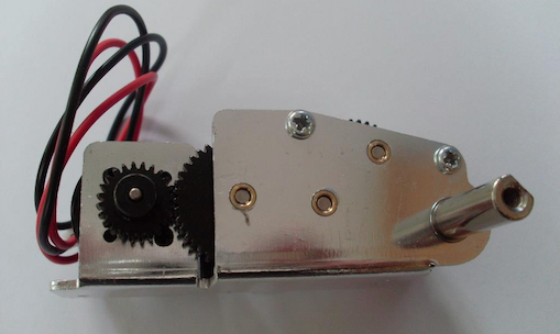

The 14006L and 14016L (low position) gearboxes here at Taigentanks look like suitable candidates, and are store-wise sited somewhat nearer to California ;)
http://www.imex-model.com/Catalog/EFLIP ... .html#p=55
P.55 of the TT catalogue... :thumbup:

I used these in my panzer iv Wirbelwind.
Taigen 5:1 steel gearboxes.
They are nice and low and fit into HL. Also, they have a final drive ratio between the standard 3:1 and metal 4:1 boxes. Enough torque for a medium tank. :thumbup:
Can send pics if them fitted if you would like to see them in a pz iv hull.

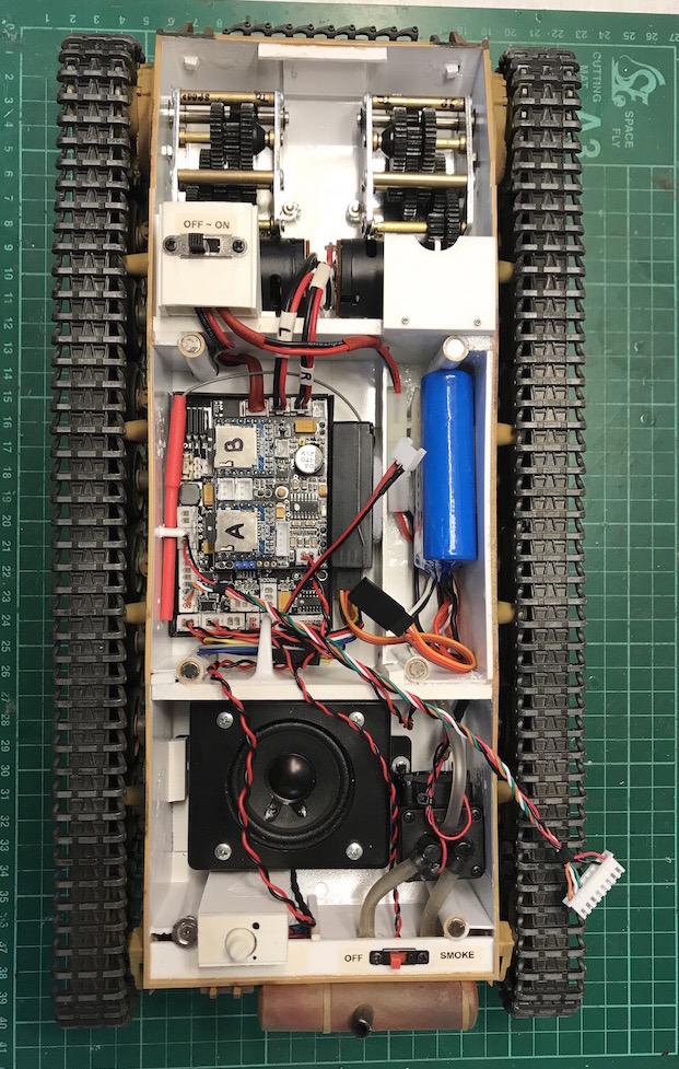

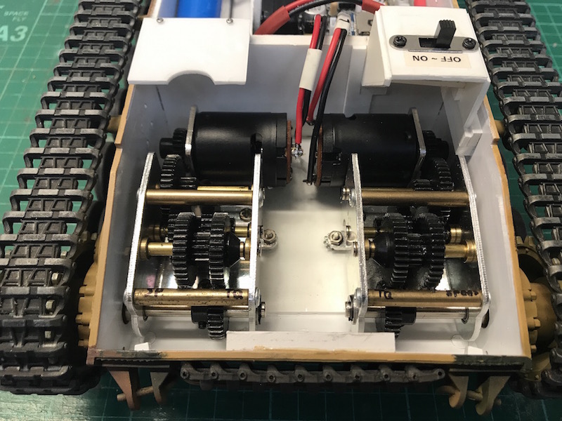

took a few pics of the Wirbelwind hull an gearboxes.
AK

Thanks AK , Steve :thumbup:
I will get in touch w Eric at imex and order a set. Thanks for the photos they are helpful :thumbup: :thumbup:
