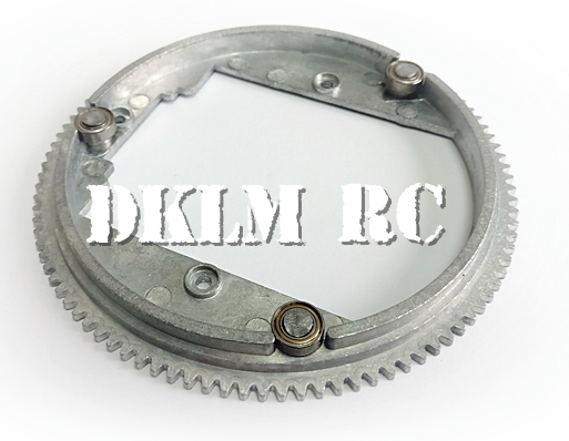

Steve if you do decide to buy the Metal Turret Ring with Bearings I would suggest you get the 360 Degree wiring harness at the same time as finding an aftermarket one separately is not easy, make sure it is the "BB" one and not the "IR" one, also you should be aware that the Metal Turret Ring comes in two sizes, Your Tiger2 takes the "Large" one.
I have two of these Turret rings but I am still wondering how much harm in the long term they will be doing to the sheet of unsupported ABS underneath them, :lolno:
Shaun.
