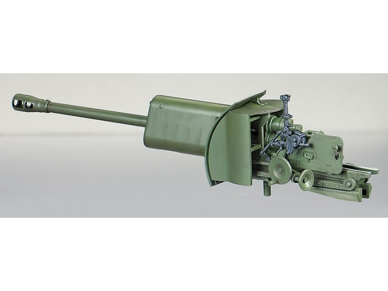

I was having a look on line and along with a load of blueprints, I found a couple of photos which may or may not be of any help.
76m gun.jpg (40.52 KiB) Viewed 5398 times
Needless to say, they are photos of models.
Re: Russian SU76M
Posted: Wed Aug 16, 2017 3:22 pm
by wibblywobbly
That's the Tamiya 1/35 kit, I have looked at a few of those for inspiration, to see how they designed their kit. I can print tracks, it's the track pins and making them strong and reliable that are going to be a pain, might be worth a go though, just to see.
