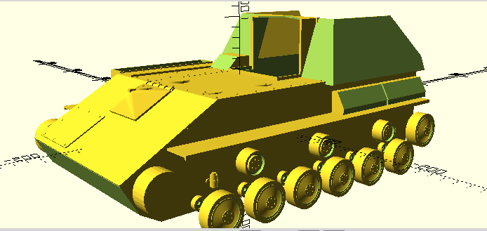

I was at Bovington and saw one of these, my brain immediately starts converting shapes into drawings, so I took a load of pics that are uploaded into the research area of the forum.
Over the following days I kept thinking about doing one, and decided to design the whole tank in CAD on the basis that if it all fits together on screen, then it will all fit together if I print it.
Parts like the lower hull will have to be cut in half to print as they are too big, but the rest of the model is separate parts, all assembled on screen. This has the advantage that where possible I can print say a hull sheet, complete with all of the attachments moulded in.
Anyway, this is where I am now, still need to do the gun and citadel internals. The tracks and sprockets will be a problem to solve. A close match to tracks can usually be found off the shelf, but these are unique, so I will either have to compromise on them, or try printing my own.

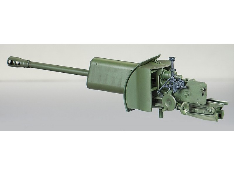

I was having a look on line and along with a load of blueprints, I found a couple of photos which may or may not be of any help. Needless to say, they are photos of models.
Richard
- wibblywobbly
- Posts: 6396
Re: Russian SU76M
That's the Tamiya 1/35 kit, I have looked at a few of those for inspiration, to see how they designed their kit. I can print tracks, it's the track pins and making them strong and reliable that are going to be a pain, might be worth a go though, just to see.

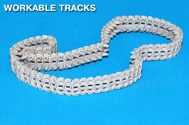

Re: Russian SU76M
Would Sherman tracks be any good?
Alwyn
Alwyn
Re: Russian SU76M
AlwynTurner wrote:Would Sherman tracks be any good?
Alwyn
I was wondering about those. There's a cavity in the HL ones that could take a drive sprocket.
- wibblywobbly
- Posts: 6396
Re: Russian SU76M
I have Sherman tracks here but they are totally flat on the inside edge. It's still looking like a DIY job. Bogeyman has a 3D printed Scorpion, which has printed tracks, and those are incredibly good.
