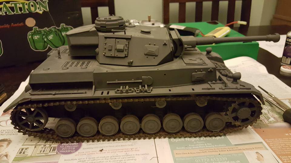

Hello & welcome to my introduction, RC Tanks are a recently acquired hobby {amongst many hobbies} & I started off by picking up a second hand Heng Long Panzer 4 that the owner had tinkered with. Perhaps a second hand Tank wasn't a good idea.So far I have replaced the RC Board, the front drive sprockets & rear idler wheels. It has a built in volt meter & some other quirks, one of which seems to be the lack of range before the radio fails to respond. The turret wont turn all the way so i'm suspecting a broken tooth on the turret ring. The gun wont raise or lower or fire. Now I don't know if I should give up on the Tank or have a tinker myself but i'm looking at buying one of the new metal Panzer 4 Tanks from Heng long or Taigen & seriously considering going outside my particular tastes & buying a Tiger 1 Tank. What I seek is an all metal hulled & turret Tank for the going price of the Heng Long Tanks.
So a bit about myself,i'm 52 & I live on the Northwest Coast in Southport, my various hobbies include Airsoft, camping, shooting,reenactment {Vikings} RC Vehicles etc. I have children so I want to get them into creative hobbies and off their phones & lap tops & I figured RC Tanks is something we can do together.
I will be looking for suggestions where I can get my Tank fixed. At the moment it's a very basic tank but it would make a good vehicle for my Son to play with and join in; if I can get it working properly.
Thanks for your time

The very first thing I would ask you to do at no cost is to lightly grasp the Cupola and twist it, (It is held in place by two lugs in slots) Lift it free and turn it through 180 degrees, It will now be facing forward.
There that hardly hurt at all
There could be all manner of reasons for the turret failing to turn BUT the Turret is not supposed to turn 360 degrees because to do so would tear out the wires connecting the various electrical connections in the turret to the hull mounted control board.

R-T I couldn't help but notice a number of empty spaces on the Tank.
All of which should be filled from an accessory bag that comes with the tank,
There should be an Aerial Trough, An Aerial Base, a rear light unit (Plastic inert), A jack, and two hooks for the rear mounted Tow rope, plus a sheet of grossly inaccurate decals.
You can buy the accessory bag from various dealers for a few ££.
