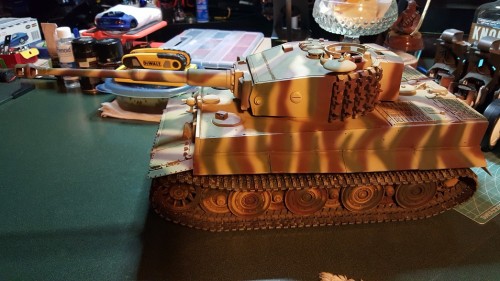

Good afternoon,
Having noticed that I am not posting a great deal of work as of late ( since 1/6 scale tends to the meticulous ), Mr. Jackalope decided to remedy this. I received a big box in the mail the other day and in it was a Combo build, Late Tiger 1! ( Well, it wasn't a complete surprise, Terry and I have been working to make this happen for some six weeks or so ) This Tiger has a metal Taigen lower with a combo HL and Hobby Boss upper with a Hobby Boss turret. All the major hatches work and there are lovely Aber brass fender skirts and scratch built, working front and rear fenders. Sound comes from four speakers and I learned from Jackalope that there was an IBU2 with amp in this Beast. Gears are black steel and the paint work is _fantastic_!! I will be leaving this paint job alone and just doing a minor eye-candy job to add tools and accessories. I'll be working on this one interspersed with the Stuart but I should soon have a working Tiger to chase Joe's M36B1 around with. ;o) I spent a couple of days repairing the little dings and knocks from shipping. After that, I built some of the wiring harness mounts inside and made a glassine pane for the Driver's viewport. More to do later but for now, here she is. Pics:

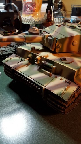

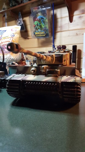

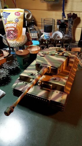

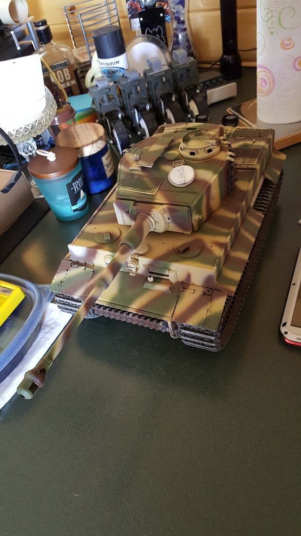

The front and rear fenders and front fender hinges are all scratch made from brass sheets. The rivits heads were made by drilling holes through the brass, slipping pins through then cutting them off.
The upper hull is a H/L and Hobby Boss hybrid. All hatches open, drivers view block is open, engine hatch opens and has a scratch made latch to hold it open like the real one.
Yes I painted it did all the custom work too, however upon seeing the works produced by you fine gentlemen I realized my feeble little attempts paled in comparison so to avoid any embarrassment I've more or less throw in the towel with my tanks.
I haven't run or touched any in over a year, no point. I'm struggling as to if I want to get rid of everything cause I do like them but then I look on here and figure what's the point.
