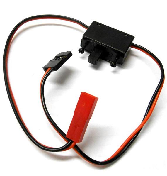

Just checking all the components in my Tamiya KT box, before i begin the build project. It took me a while to discover that some bits (an extra plastic barrel for example) are not to be used, and then I discover this on off switch- (illustrated).
Given that the DMD/MF units already have a power switch hardwired in, I couldn't see what this was for. It's not listed on the parts sheets, and not mentioned in the build manual, nor is this mysterious unit mentioned anywhere on the net as a Tamiya product.
After further research, I found something identical listed as an 'RC receiver on/off battery power switch'. :S Being none the wiser, even though I'd noted that the switch had Futuba style male and female connectors on either end, I'd guessed that it was to connect a receiver to a battery supply, but why? There seems to be no need for it in the kit; but I always like to prepare properly before building something (snowmen not included) and hence the query. :problem:

That's for running a separate battery pack for your radio. Usually a 4 cell AA pack. This was mostly used before that came out with the battery eliminator circuit (BEC) in the newer radios. Maybe they still put them in with the radios to give you an option.
If your electronics do not have a radio priority circuit, you might think about using a separate pack. I remember an R/C car that took off as fast as it could go, with no control. The motor took all the current and the servo could not move!
I'm gonna guess that you won't be needing it.

Some interesting tidbits of information there, guys. Thanks. The BEC is a new one on me. I had no background in RC whatsoever before getting hooked on Tanks, and missed the background 'education' in RC terms, tricks and tips and technical jargon, that many others bring to the Forum. But I'm learning fast B| :haha: :thumbup:
The BEC drops the battery voltage to a safe level for the receiver, so that the receiver doesn't need an independent power/battery source (and thus the on off switch..Tamiya include). I get that. In preparing for this build though (and No, Ausf, I haven't started yet..) I'm just assembling all the bits I need, from cements to cutting tools. Hence a brace of queries on those topics too. But I also bought a Futuba Attack 4 WD 2.6Gig TX/RX set up to go with it as I'd read in the online build manual that it compatible with the DMD/MF-O! without going though set-up calibration. More than that, it is powered directly by the DMD unit, which presumably includes the BE circuit. Incidentally, it's great that you can download the build manuals before buying the Tamiya of your dreams, so that you can see what you're letting yourself in for.. :D I'm glad that Taigentanks are facilitating that too with their products. :thumbup:
