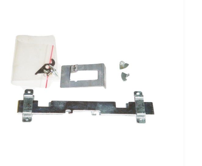

Re: Hull lock.
Quick release for Tiger 1
Tiger 1 locking system.jpeg (29.87 KiB) Viewed 3182 times
rctank.de sell this kit. It certainly fits budget Taigen models without the quick release mechanism, and I believe the Heng Long can be adapted to use it as well. :| Others will recommend the use of ( 8mm) magnets to bond the hulls together.
Here's the link to rctank:
https://www.rctank.de/Tiger-I-lock-system
Re: Hull lock.
..Just having re-read your query, I note that you didn't mention the model needing the adaptor. For some reason, I assumed that it would be the Tiger. Most of the Taigen Pro series of models (from Sherman, and Tiger through to T34 and more) have their own version of this release mechanism.
