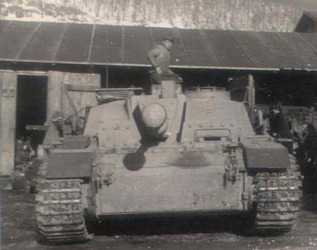

Winterketten are the blade type used in the early days of the conflict.
Ostketten came out later and were genuinely wider tracks and much more robust than the early blades type.
Yes, either version will fit a 3 or 4 .
Your Schurzen will need careful placement to clear the outer edge of the track though.

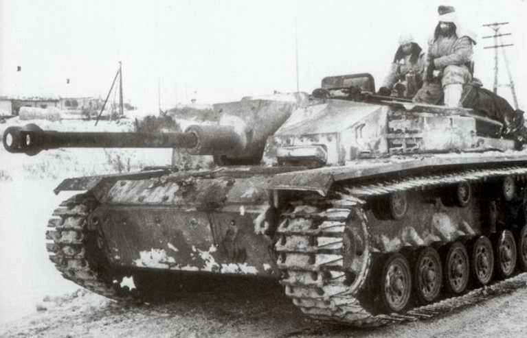

It'll depend on which particular vehicle you're modelling, Mick. Ostketten only appeared in 1944, so mid-production panzers and StuGs would have winterketten.

And to note also is that the Winterketten tracks pre-dated the Schurzen.
The top picture shows nicely the lack of Schurzen appendages.
They could not last once the snow melted and needed to be changed-an added logistics load, so the Ostketten were designed to allow much better snow operation but allowing the durability to handle dry terrain as well.
