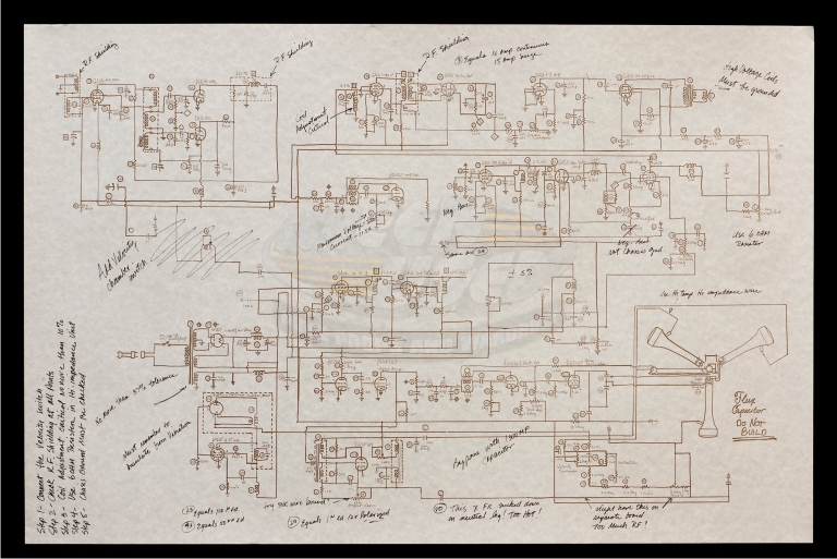

That was after he went to the future and came back. Originally powered nuclear from the plutonium stolen that was supposed to go to the Libyans. Wasn't the power source I was referring to, simply the magic of the magnetic field generated to rotate the unpowered motor hence the word "flux" and the "capacity" to generate secondary power similar to flux capacitor. Of course if you hooked up a large enough power source to the tank to produce the necessary 1.21 gigawatts and speed the tank to 88 mph then Gary would have a time machine... :D
flux capacitor formula.jpg (78.92 KiB) Viewed 1633 times
