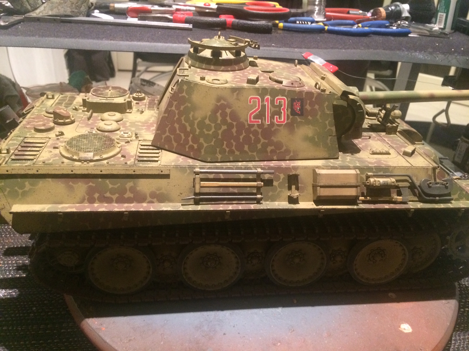

Got a couple of projects sprung on me from the guy that paints & supplies figures.
This one is a very well presented 'Disc-Cam' Panther.
As the Tamiya tanks open up completely, it makes fitting tow cables in the recently used position a bit hard.
He has asked me to make him 4 tow rope kits for Panthers & jagdpanthers so he can retro fit them to completed builds.
I will admit to having rather a (In the words of Rik out of the Yong Ones) runny bottom due to nerves when 'A' an expensive Tamiya is presented for retro-work
'B' Said expensive Tamiya is in a completed state
'C' Said expensive Tamiya is owned by the only person I actually in real life know that can make figures NOT look like pissed clowns on the way to a Mardi-Gras 8O 8O

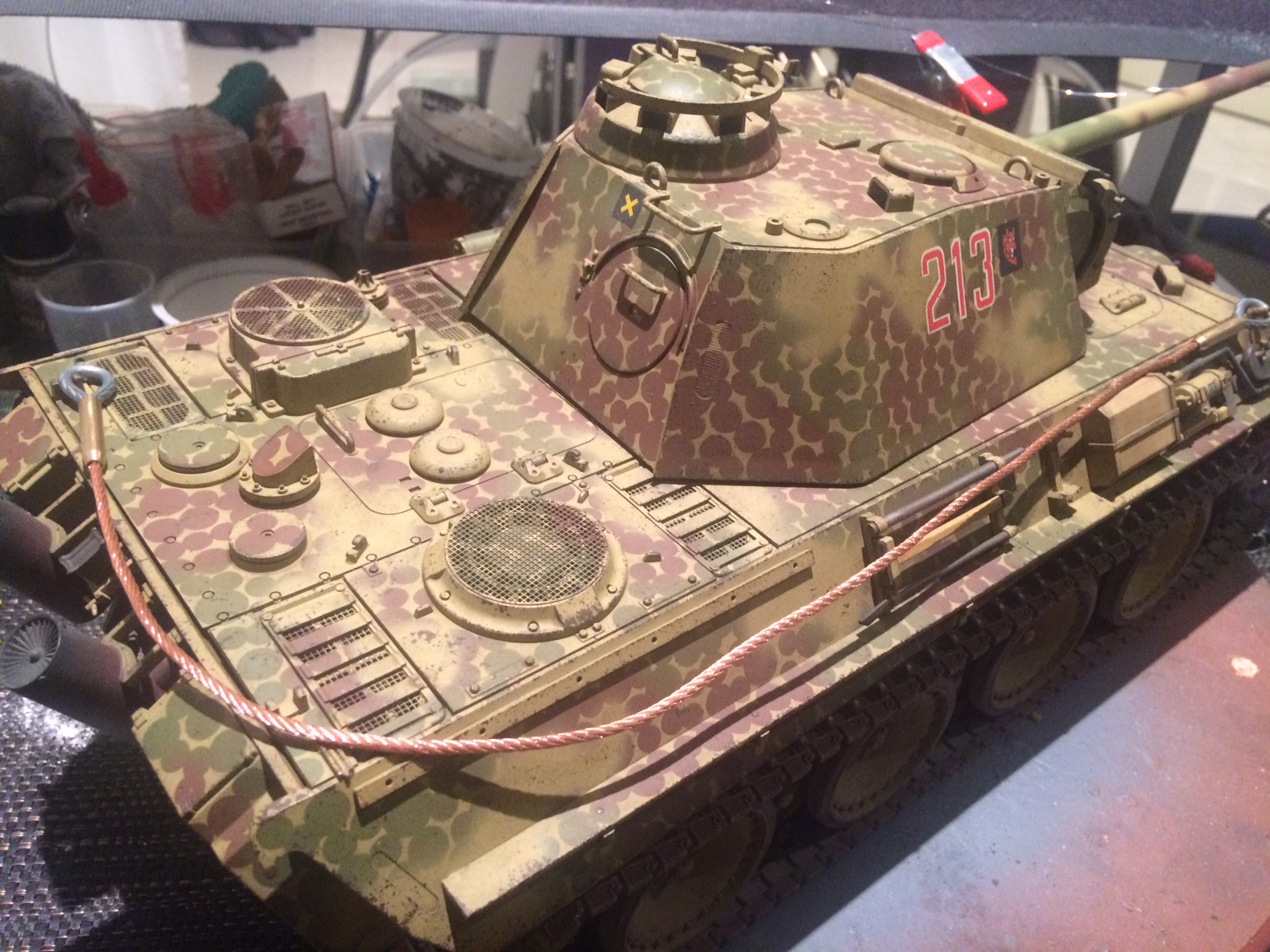

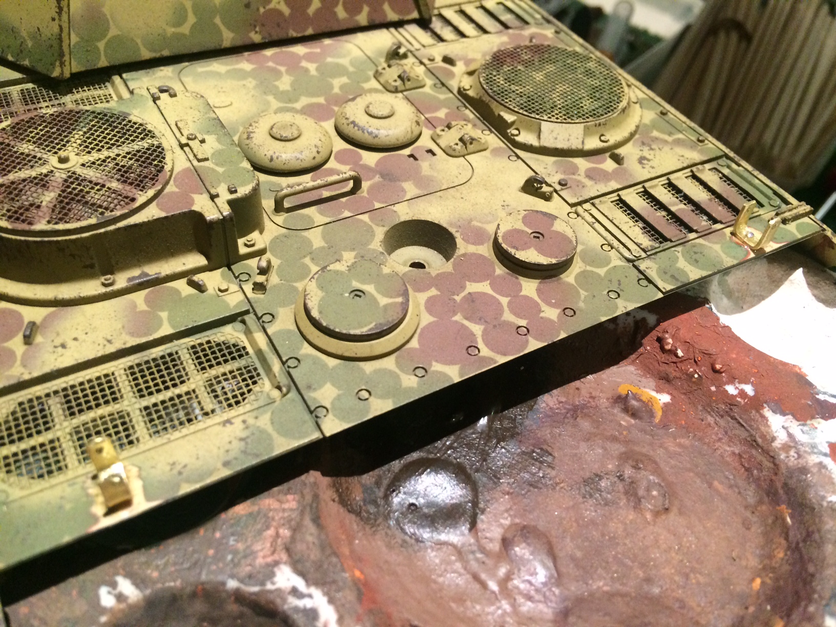

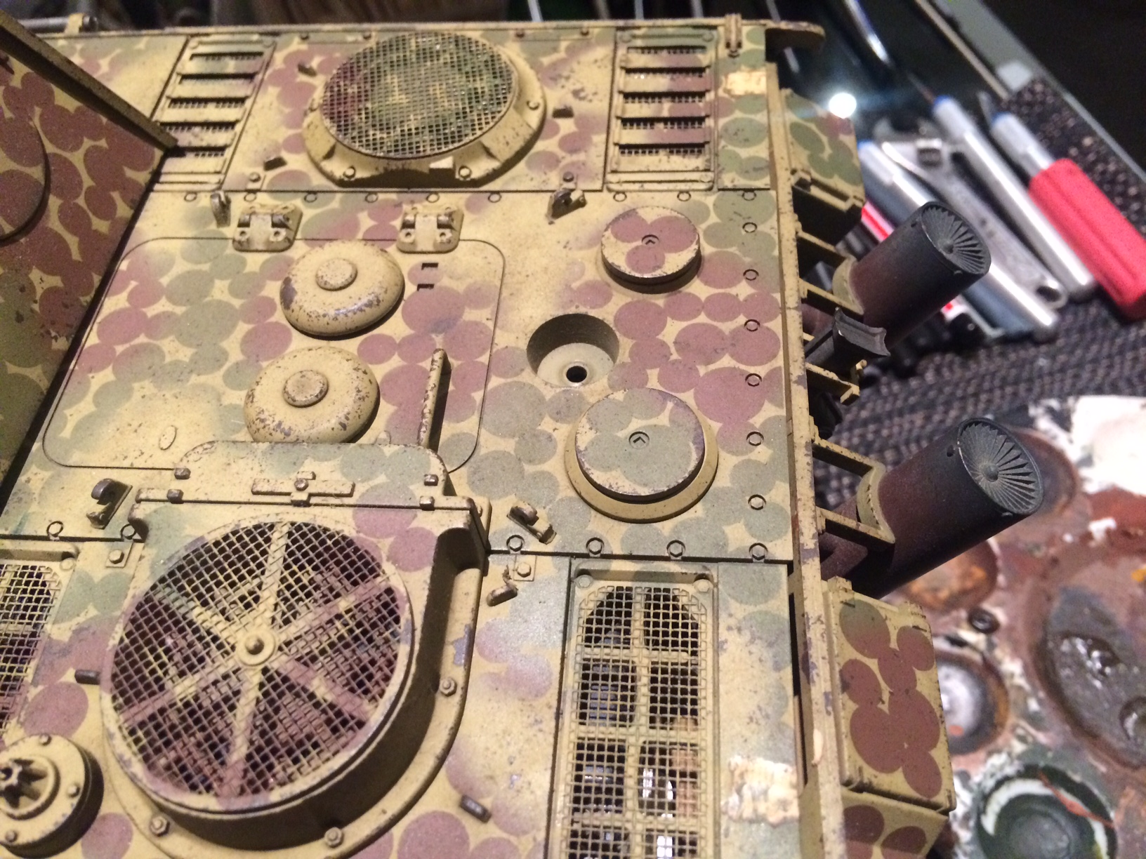

I gently removed the factory rear deck cable mounts & dressed the spot where the new mounts will go.
Folded two new mounts out of brass flat bar & drilled pin holes across.
I used a dress making pin through each on the bottom to help secure them to the hull with Gel super glue.
I will add chains & pins to these, and drill the front cable retainers for pins as well.
I shortened the cables to length being carefull to allow enough to fit over or around the currently absent spare track links on the rear.
Then make another 3 sets that e can fit as required.

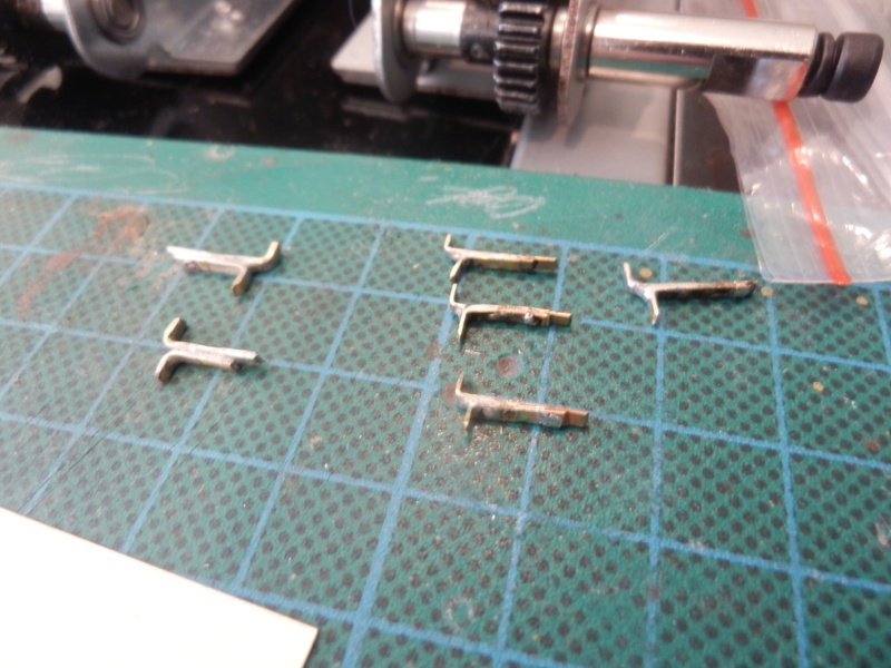

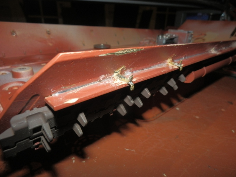

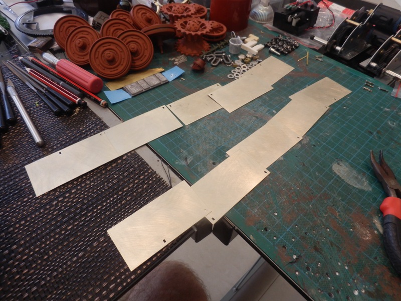

Ive got one of these Panthers back on the bench to fit a set of Aber skirts.
The owner wants them to be very robust, so Ive not used the aber hangers.
I have made a set of brass flat bar hooks back to back soldered together, removed all the tamiya mounts and secured the fender strips with PVA glue along the entire length of them.
Drilled holes through each of the hanger positions and secured the new brass hooks with high impact super glue, supported again with PVA.
Now I know that the look of made hangers is not the same as the Aber diamonds, but these will stay on under impact and allow easy removal of skirt plates as required.
Its destined to be the Herman Goering Div tank R01 I believe, disc camo on the skirts & different hull etc.
Half the hangers are on, 6 to go.

im onto the PzIV schurzen now, all brass, hell of a job that is, but it will be well worth the effort once its finished.
