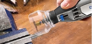

I saw Painless using one of these, looks like a good idea, saves wearing the glasses.
th (6).jpg (17.24 KiB) Viewed 4214 times

Great video on YouTube showing cutting disc guards made from top of plastic bottles, good idea I may try. Just search Dremel guard. Be safe!
