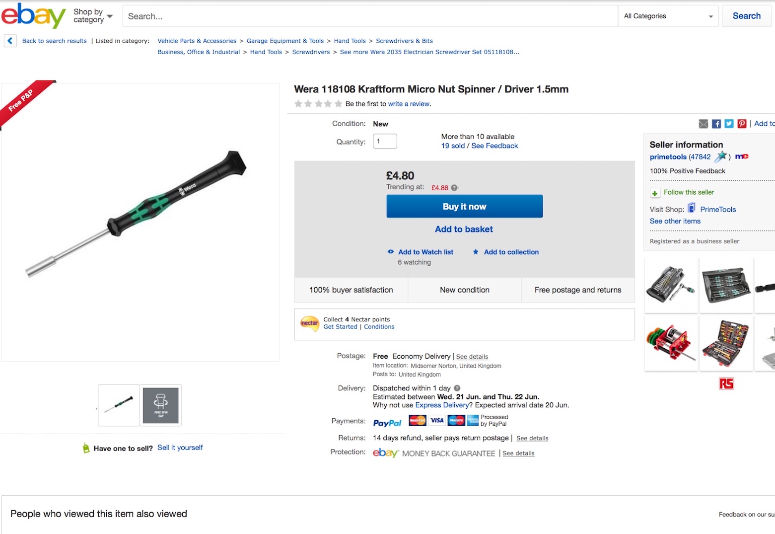

Try this firm, Shaun. They offer a wide range of screw and nut drivers that meet modellers' needs. https://www.digikey.co.uk/products/en/t ... %20drivers I bought a set ranging from 1mm up to 3.5mm through Amazon (Japanese made), but it was quite pricey. In addition, don't Prime-miniatures (one of your fave outlets :think: ) offer wee nut drivers? I bought a 2mm hex driver form them; but again, it wasn't cheap. A German import, I think (like the English :haha: :haha: )....

This is the brand that I bought,. Shaun. Perhaps it would be utopian to hope for a 1.6mm driver, but with a judicious spot of enlargement, this tool could be your best friend :D If you use this size frequently, then I'd advise you to invest in one .. :thumbup: .
Spin your nuts in style....

..and you just described the process I used for fitting most of those tiny bolts in the Cromwell sprockets. :D The pin vice can work as pretty well as a nut spinner, and did, until the Wera tool I'd ordered (2mm) from Prime-Miniatures dropped though my letter box. Then I took the plunge, and bought a small set of their (excellent) spinners..
