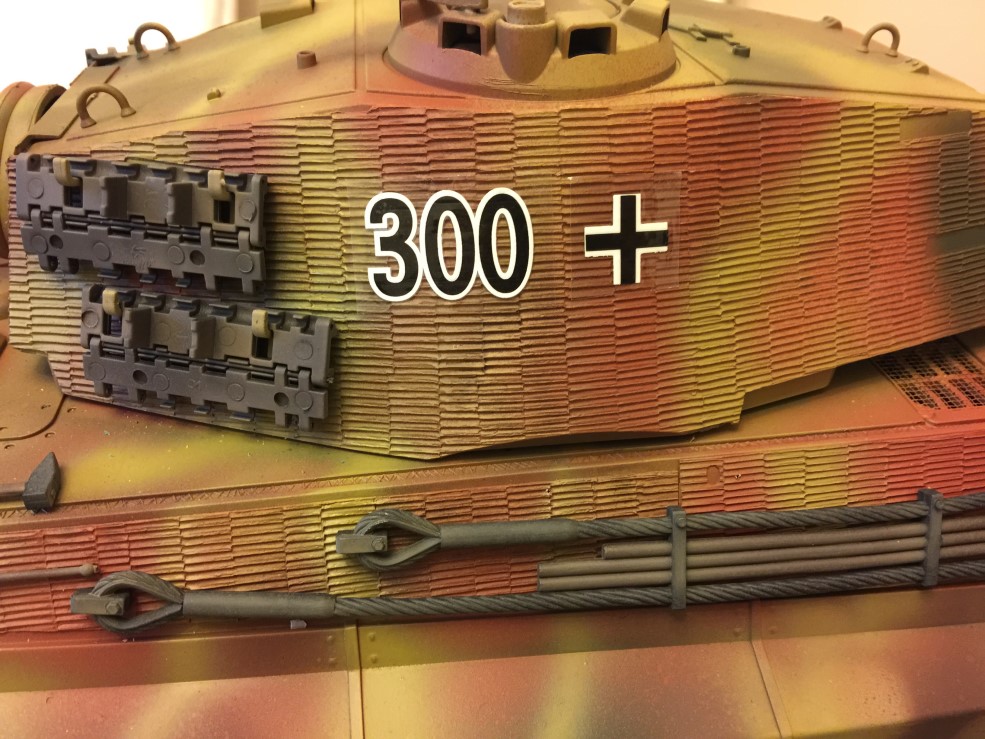

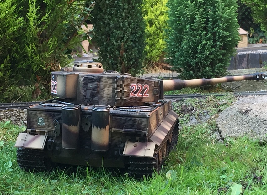

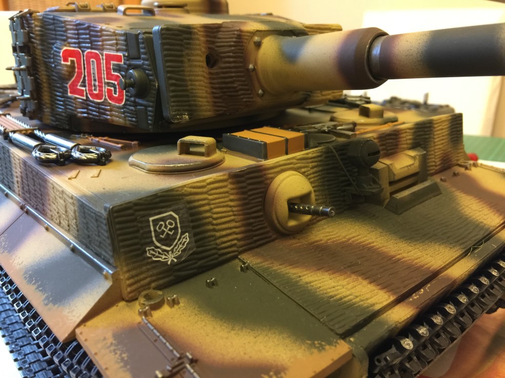

I have tried masking.
I have tried decals.
Masking produces the best results - for me at any rate.
See what you think.....
Masking:
Decals
Masking:
Decals

Tiggr Hi, I agree completely with you about Masking as well as Stencils,
I use "Pentel" Pen Brushes to apply Numbers and Letters to my Aircraft and Armour,
But the question was about Decals and I am sure you will agree that there are many items requiring symbols and intricate small detail that only an often multi-coloured decal can provide,
A fire extinguisher on a Tank is a standard fitting but the difference a fire extinguisher with a well applied decal makes highlights the whole Tank when you include such detail,
Any model will usually benefit from both kinds of decoration.
I don't know if I have said this before but your Tigers are an inspiration,
And the true life diorama settings add even more to the quality of your work.
Shaun.
