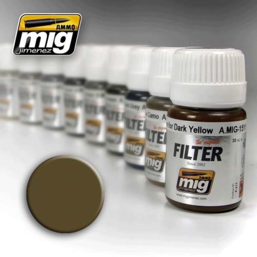

Thanks tom. Would filters and pin washes be applied by a traditional brush or can they be airbrushed on? I am looking for something that would take the edge off the camouflaged colours, if you understand what I mean.

Pin washes brushed, filters can be either brushed or airbrushed. Sin do a filter for tie colour camp that might be of interest.silversurfer1947 wrote:Thanks tom. Would filters and pin washes be applied by a traditional brush or can they be airbrushed on? I am looking for something that would take the edge off the camouflaged colours, if you understand what I mean.

Is this the stuff?http://www.ebay.co.uk/itm/30ml-Tan-For- ... SwFdtX0r0S
Richard
Re: Painting Techniques and Weathering.
Yupsilversurfer1947 wrote:Is this the stuff?http://www.ebay.co.uk/itm/30ml-Tan-For- ... SwFdtX0r0S
