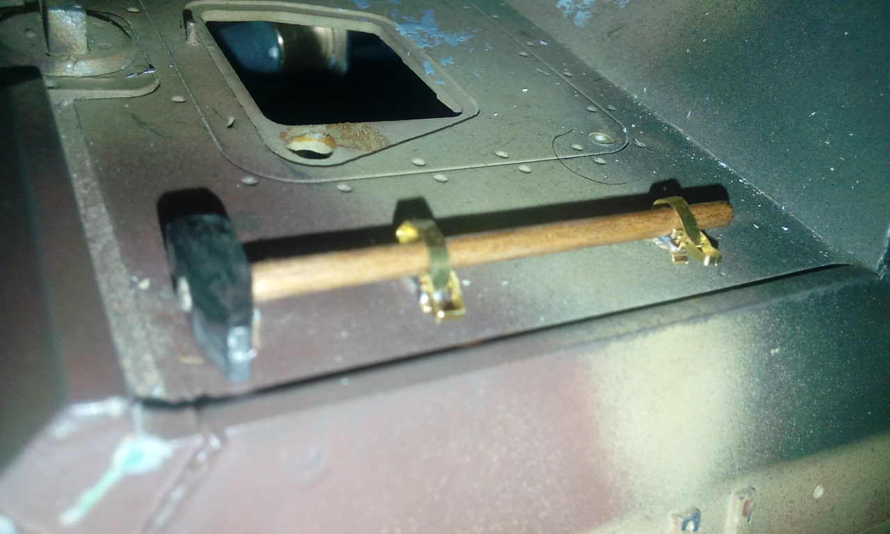

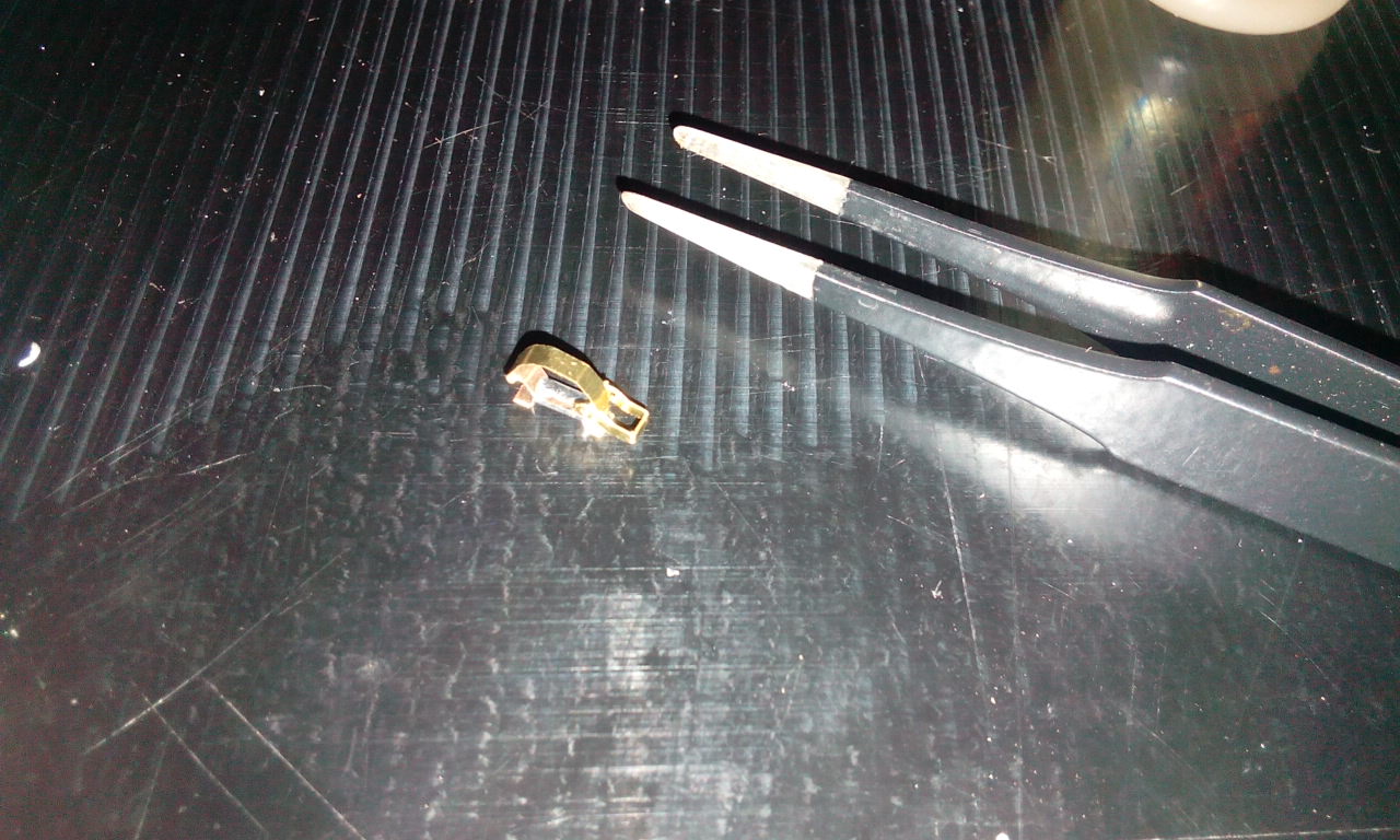

So last evening I had some time and began making some PE parts for the Jagdtiger. Started with the clamps for tools and then made one of the rear fenders. Wiating on the front fenders to arrive still and also need to buy more stuff from ETO and rctank.de. But...it is a start.

Nice. Those clamps seem a bit larger than the ones I have. Where did you get them from?
