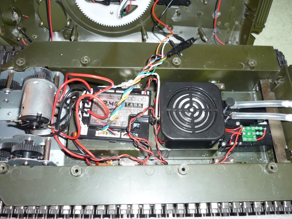

Hi all, here is the start of my mato Sherman.

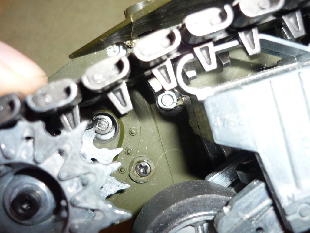

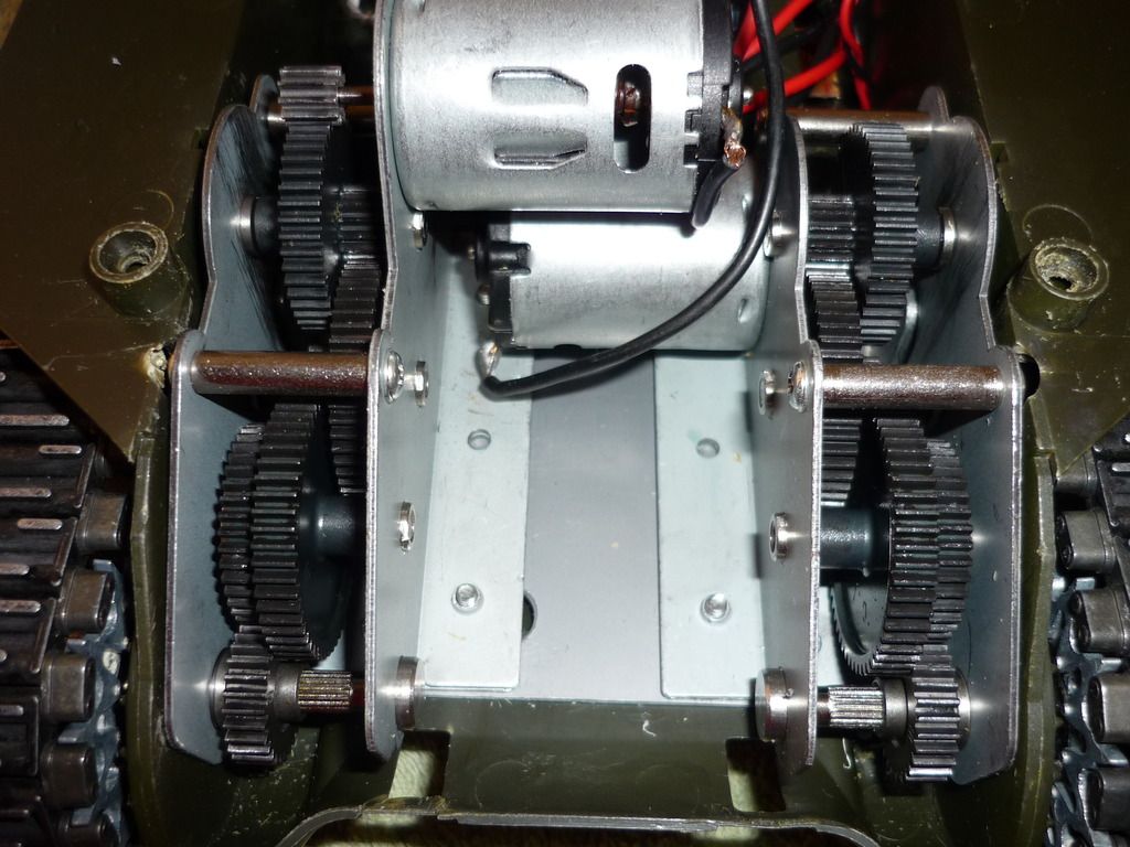

Heng long steel gearboxes fitted, the original mounts were cut away and the gearbox casings were modified,
gearboxes,suspension,tracks supplied by dave (forgebear) :thumbup:

Re: Plastic mato sherman/ Heng long steel gearboxes
It was a bit of a shoe horn job.

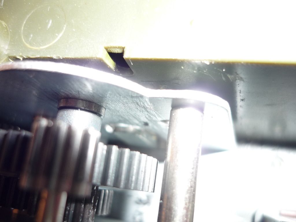

Gear casings were cut to clear front bogie mount.

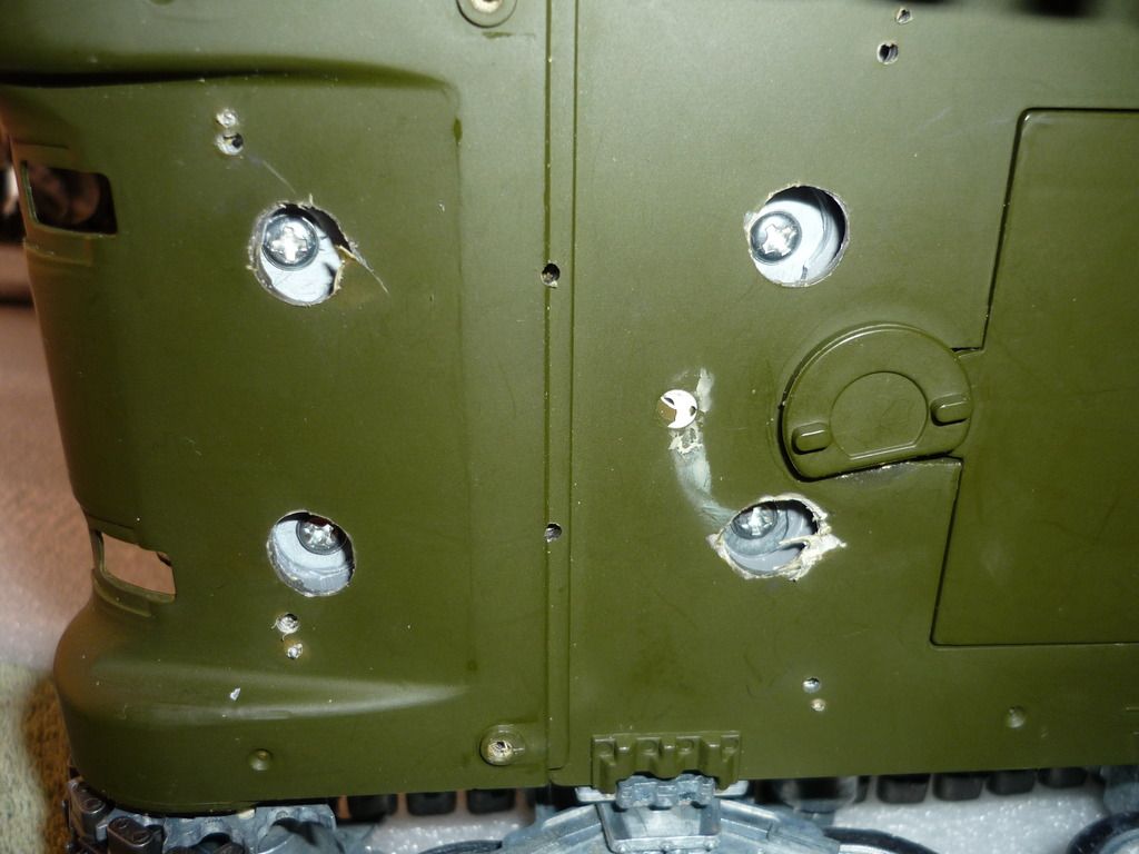

Screw from original gearbox screws into gear casing, makes it nice and solid.

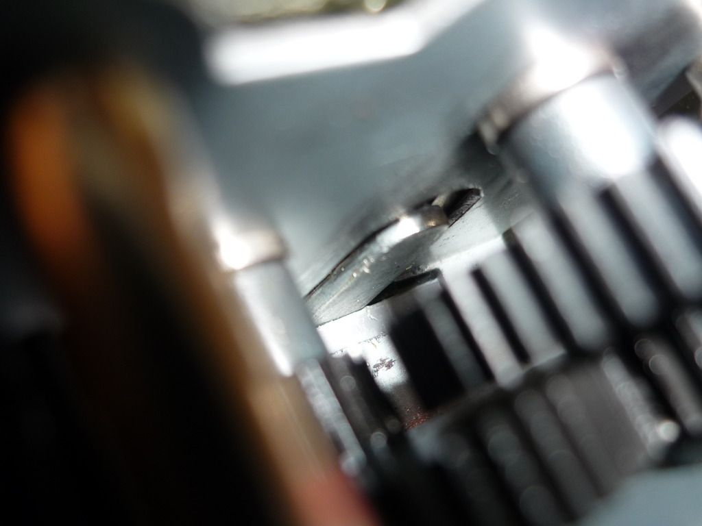

I have made it so I can strip the gearboxes in situ.
A bit of a lash up to get it up and running.

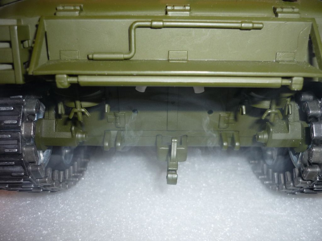

Some smoke :haha:

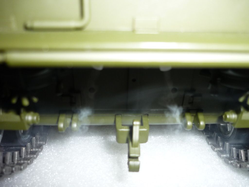

Some more smoke :haha: :haha:
[URL=http://s1322.photobucket.com/user/pshoo ... f.jpg.html]Image[/URL
Pegs glued into body mounting screws locate into lower and locate it in place, will add magnets after.
