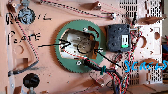

Vanguard, that's a great tip. Now I know how to get rid of the click in my recoil! :D
Would you happen to have a photo to show exactly where to grease?

Um no, but I will see what I can do for you Max-U52 :)

Here is a pic of the base of the Taigen recoil unit on my Tiger but my Panther is the same and had the same click. First its easier to remove turret from tank, then remove the three screws and spring, now I fired the gun then turned off the tank half way through when the plate has sprung into the fired position and before the barrel moves back into its original position. This makes the spring slack and easier to remove and replace (but not essential). Then apply a liberal amount of grease to the plate where it slides on the main unit and the main unit. then replace plate and spring in the middle and three screws, now when you fire there is no click yipeeeee :)
Max-U52
Posts: 3879
Location: Detroit
Re: Barrel Recoil
Post by Max-U52 »
Very cool. I'll give that a try. Thank you.
