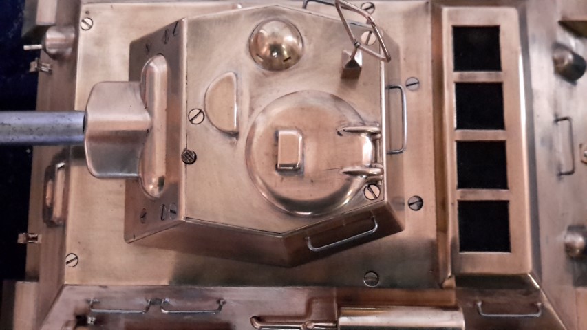

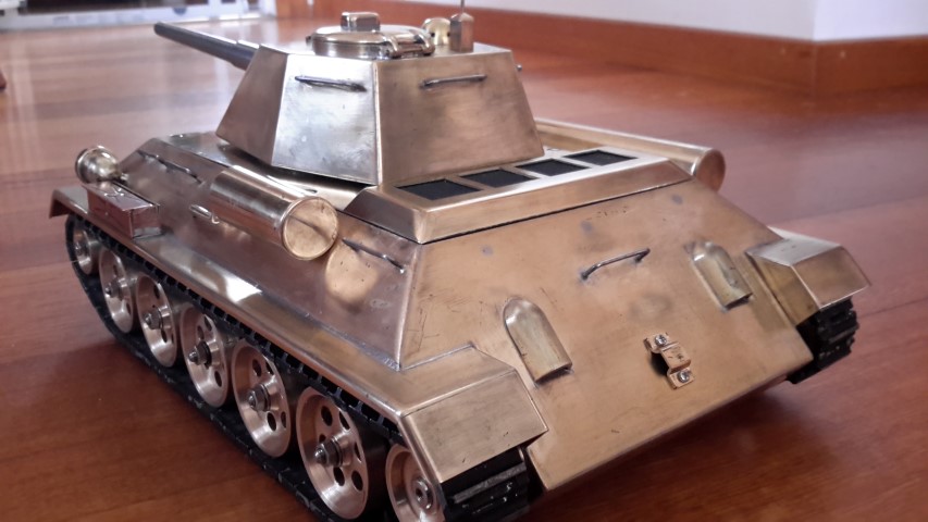

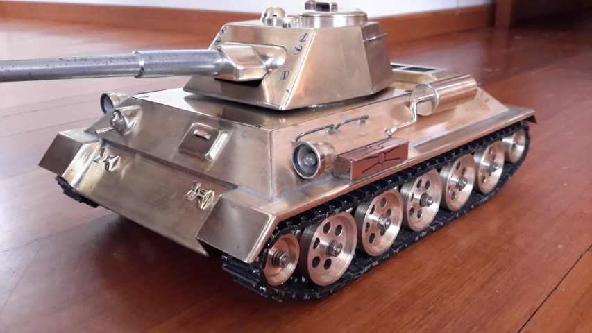

- Build this T-34 tank in 1965 from a East German hobby magazine that was published in the early fifties. The tank is totally made from brass and soft soldered together it weighs 8.5 Kg. Each track has 62 links and is made from steel. The gun fires 4.5mm caliber bullets.

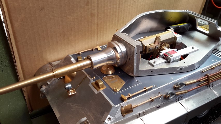

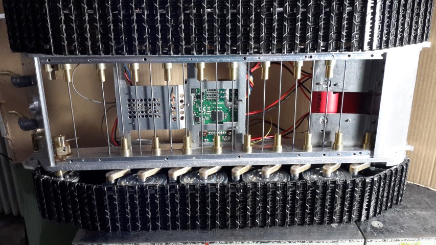

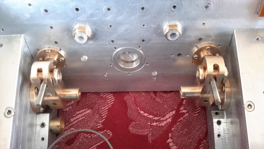

I am sorry that it has taken so long for a replay I just had to many other commitments. Thank you all for making feel welcome it is very much appreciated. To answer some questions the tank is scratch build weighs 15 kg is mainly aluminium the smaller parts are from brass. As a controller I first used a Elmod Pro but had many problems with it mainly steering the tank without blowing the fuse. The Elmod people where responsive but where saying the controller can not handle 15 kg. So i tried the Clark TK22 and am very happy with it. As gear boxes I used the Taigen Premium Series 3 very good quality. The whole project gave me great satisfaction and my even jet start building a Tiger1

In replay to scratch building a Tiger 2 being an easy project. I must disappoint you I found it was not an easy project at all. Every thing is on a different angle nothing is square. And to make it more difficult I wanted to be able to take the tank apart in all its individual pieces .So all the pieces had to be screwed together. Drilling and tapping was quite some challenge. For controller I use a TK-22 and as a gear box a Taigen series 3 1:5
