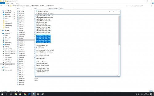

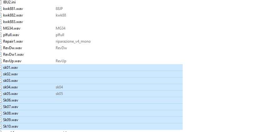

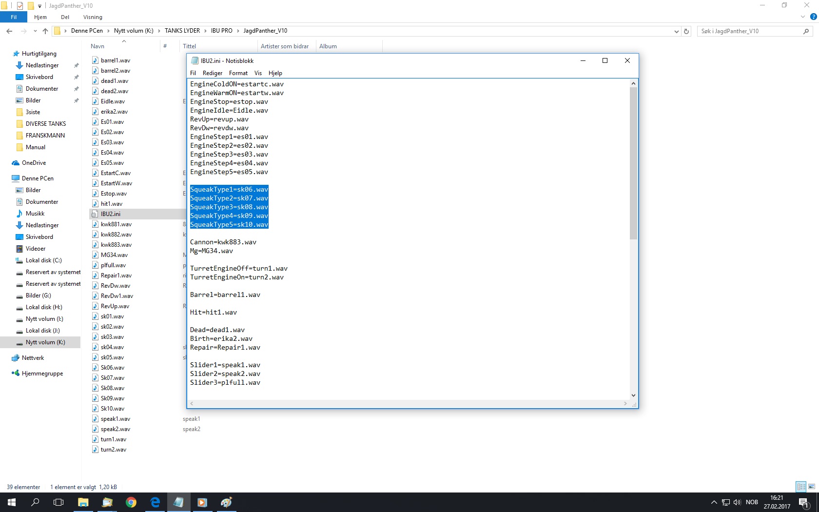

On the ibu2 there are usually 5-6 'squieks that play's random . They can be turned on/off by editing the sound INI file on the SD card
On the IBU3 you can add them in sound slots in the programing software for the Board.

on the ibu2 it is like this
