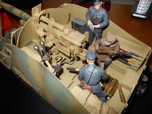

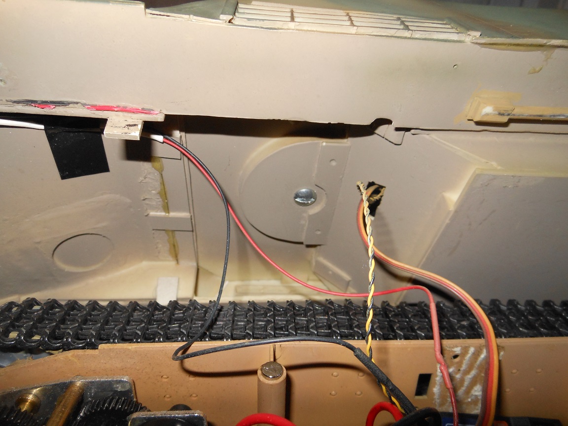

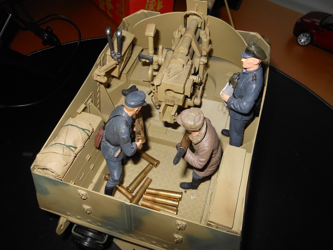

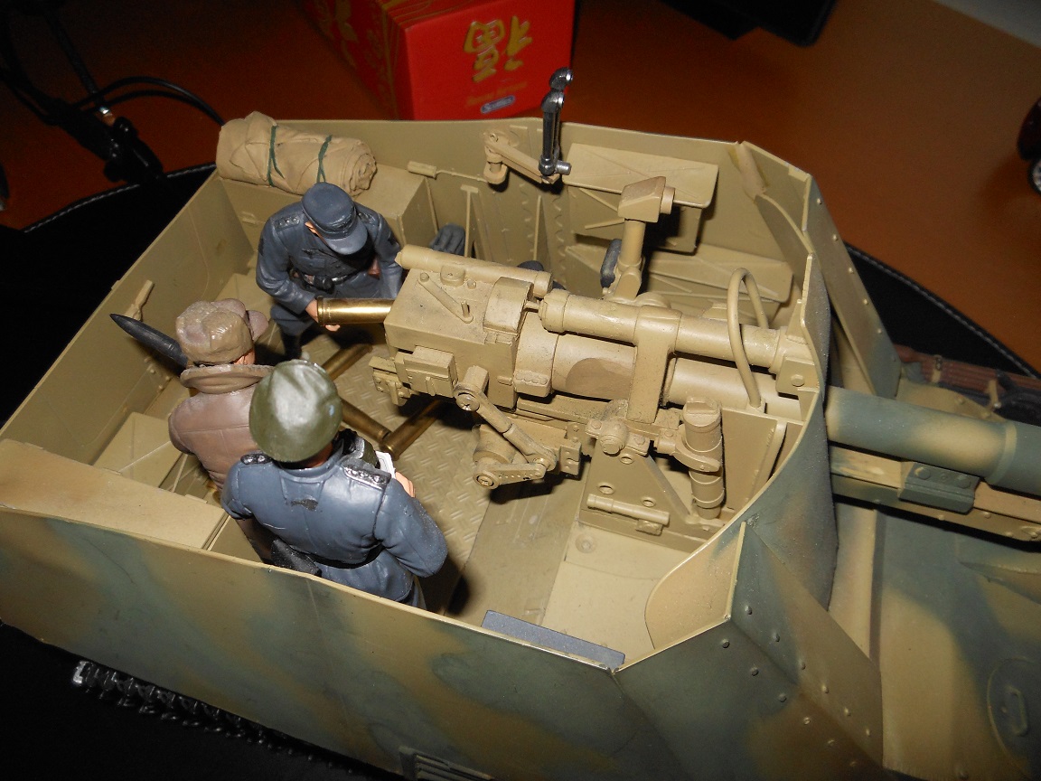

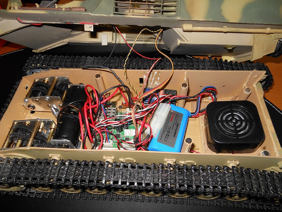

Louis, I built my Juck Nashorn on a Heng Long Pz IV chassis a couple of years ago. Here are some pics of the inside compartment as well as the inner hull so you have sense of spacing. I didn't do rotation or elevation, but did built-in a servo recoil. I think rotation with Heng Long units underneath, and elevation as well with with some linkage rod off a Heng Long pulling elevation unit.

Thanks Michael !
Cutting the battery box away from the bottom hull... now why didn't I think of that ? it's so simple. Yeah, this makes room for the gears. thanks !
Louis
