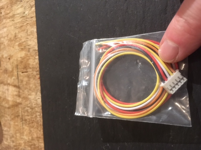

Hi all,
Just got my first of two Tamiya Battle Unit with base for my IBU2/3s, and had expected the connector to go directly from the TBU onto the IBU2/3 but it doesn't fit ?!?!? I am still a little stunt but is there multiple verions of Tamiya Battle Unit connectors ?

To the best of my knowledge, all Tamiya battle units have plugs that only fit the Tamiya control boards. I similarly believe that Clark, Elmod and IBU boards share a plug that won't fit the Tamiya board. I have a Vampire unit fitted to my Tamiya Panther which won't fit the Tamiya electronics. Incidentally, the Tamiya IR Emitter is fitted with a plug that won't fit the IBU etc, and vice versa..

Hi there the wires are the same configuration best way to sort it would be to get a lead from Ian at Rc tank electronic and cut of the tamiya plug and solder the lead on with the vampire plug.
Or have a chat to Ian and see if he has just the plugs on there own :thumbup:

Thanks guys. I have no problem re-wiring with the correct connectors. I guess I had hope it will just be plug and play since I purchase a TBU and the board has a plug labelled TBU..... :-)
I guess the other question is, if I am rewiring anyway, do I still have to use the Tamiya port for the TBU, or can I just wired the TBU to the Heng Long IR port provided that I have all the pins sorted out (i.e. 2 for the LED and 3 for the receiver).

The ibu2 has a port for connecting the TBU.

If you check it you can see that you can connect the TBU. I did some hand made IR units and the conector in the tamiya electronics is the same that I use in my IBU2

I have plugged tbus into ibus, it's most definitely plug and play (unlike Clark) I can only think you're using the wrong socket
