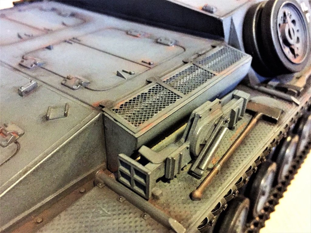

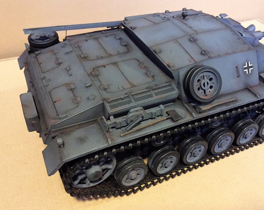

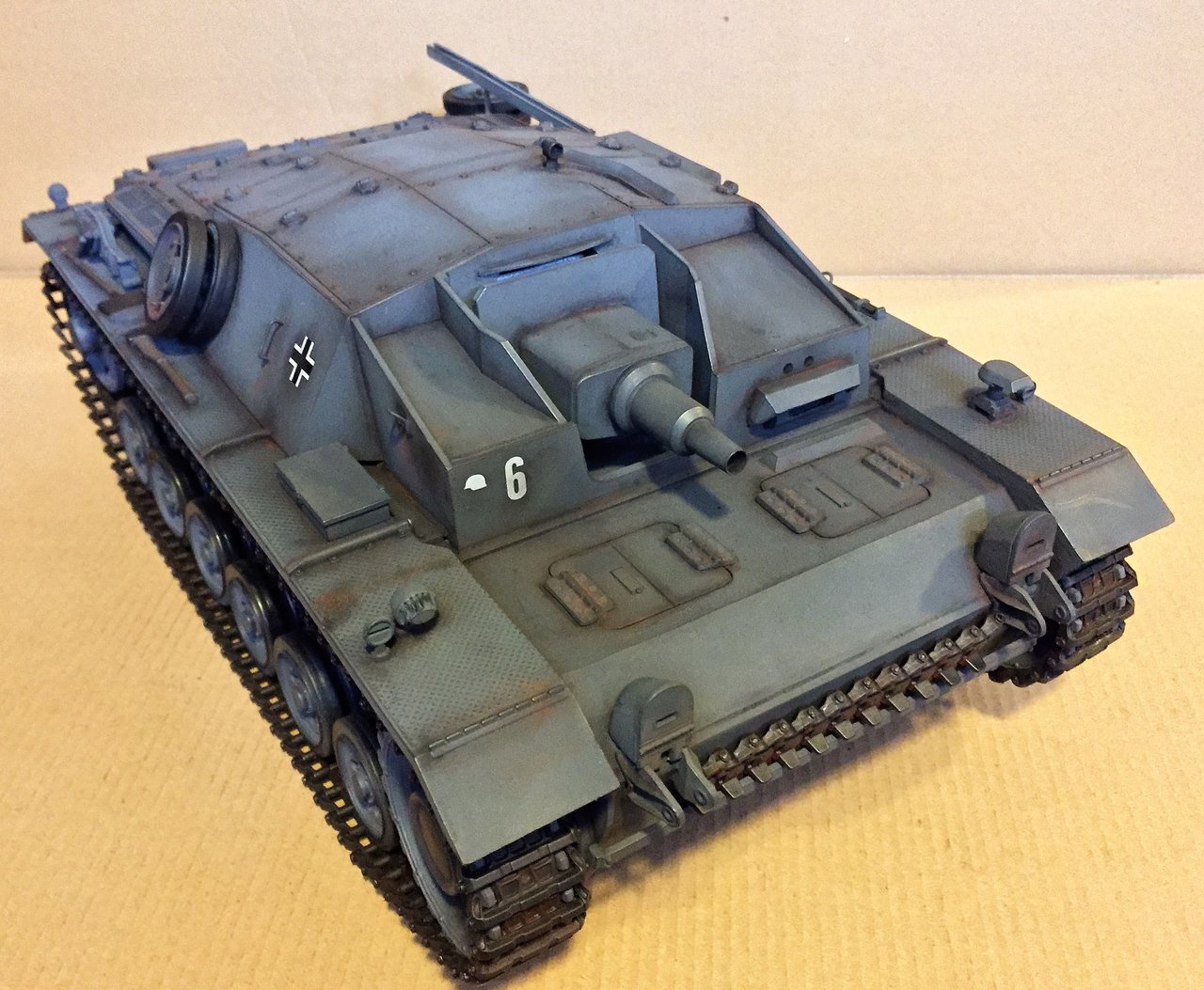

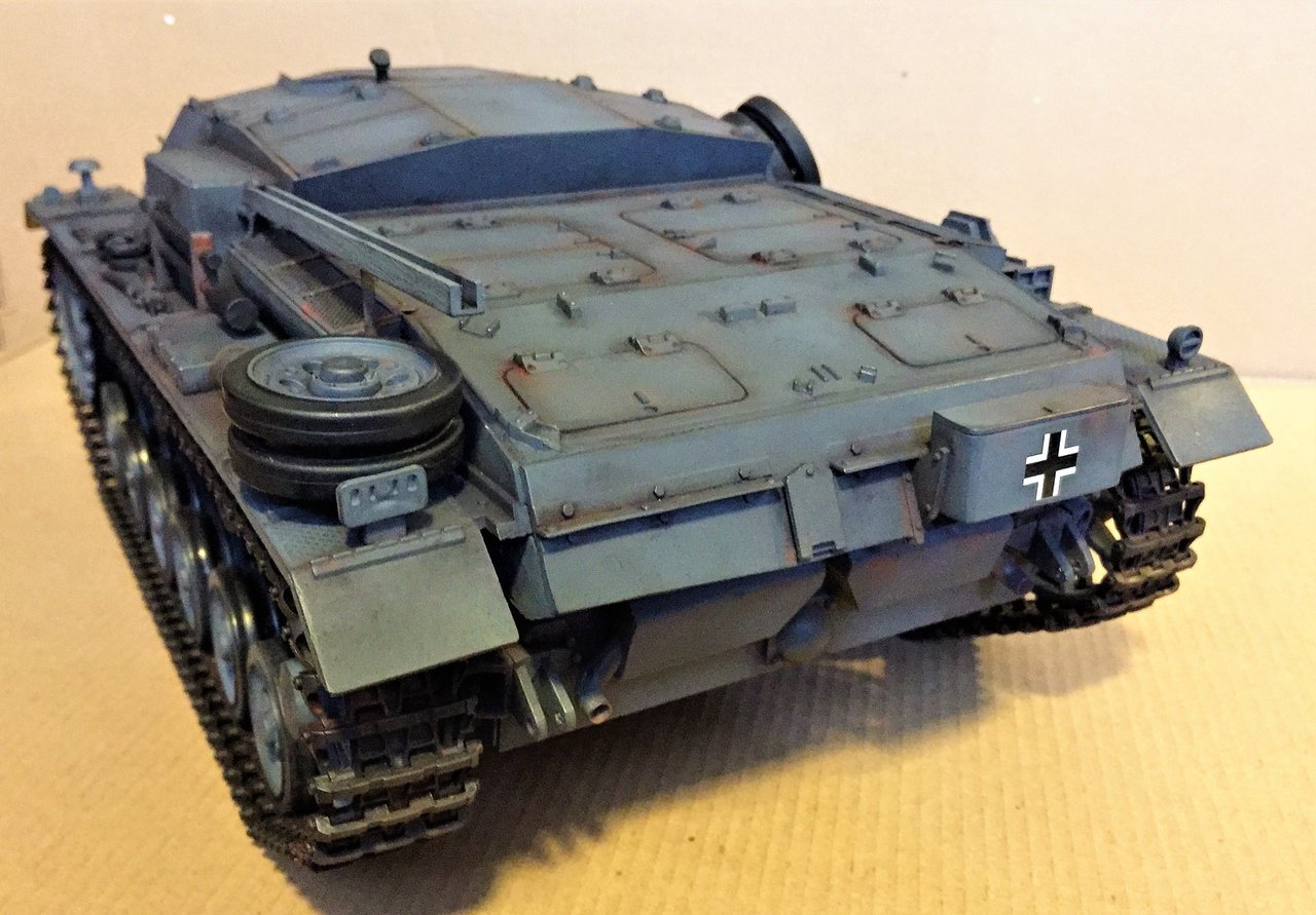

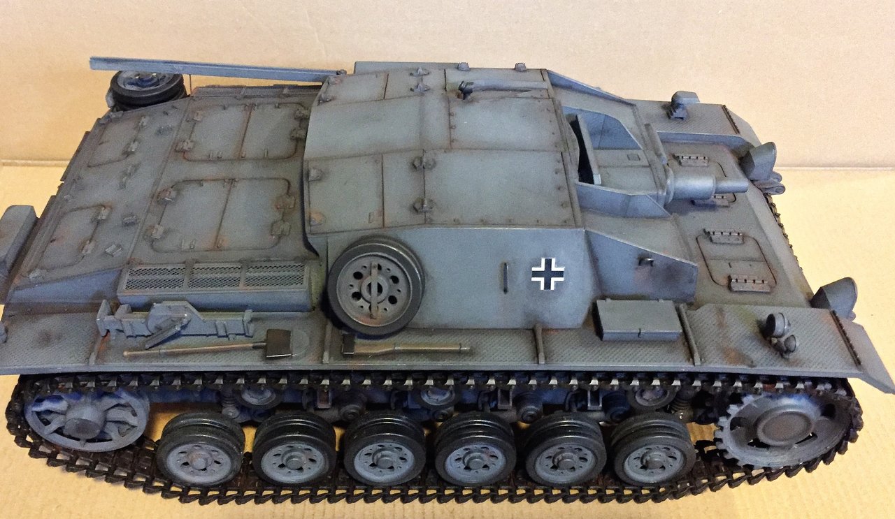

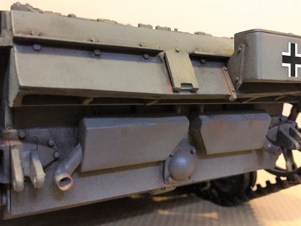

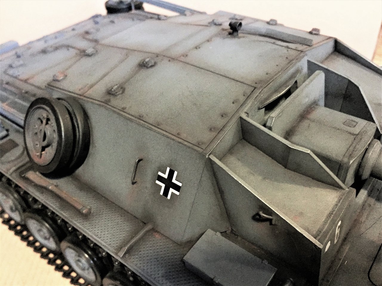

Here is a Stug III Ausf D model using the Profiline resin conversion kit and mounted on a HL Tauchpanzer III hull. It's a rather difficult conversion that I made last year. It's hard to get it right. Still not fully happy with it but I think it looks ok.
Regards, Louis

I would be very happy indeed with work as good as that.

Your work is inspiring and detail rich. Excellently done! I finished up one of the Profiline StuG lll B conversions in 2015 and understand the amount of 'fun' required to turn out such a well done piece of armor.

Louis I admire your abilities to create such a nice version of early German armor
I think it's more than alright it's quite stunning.
Whatever you did keep doing it it's great work!
I've always been a fanboy early armour examples and this one is top notch

Lovely model

You are being way to hard on yourself. Were it that we could all be so talented. Beautiful work...beautiful paint.

Looks amazing.
Have been tempted by one myself.
