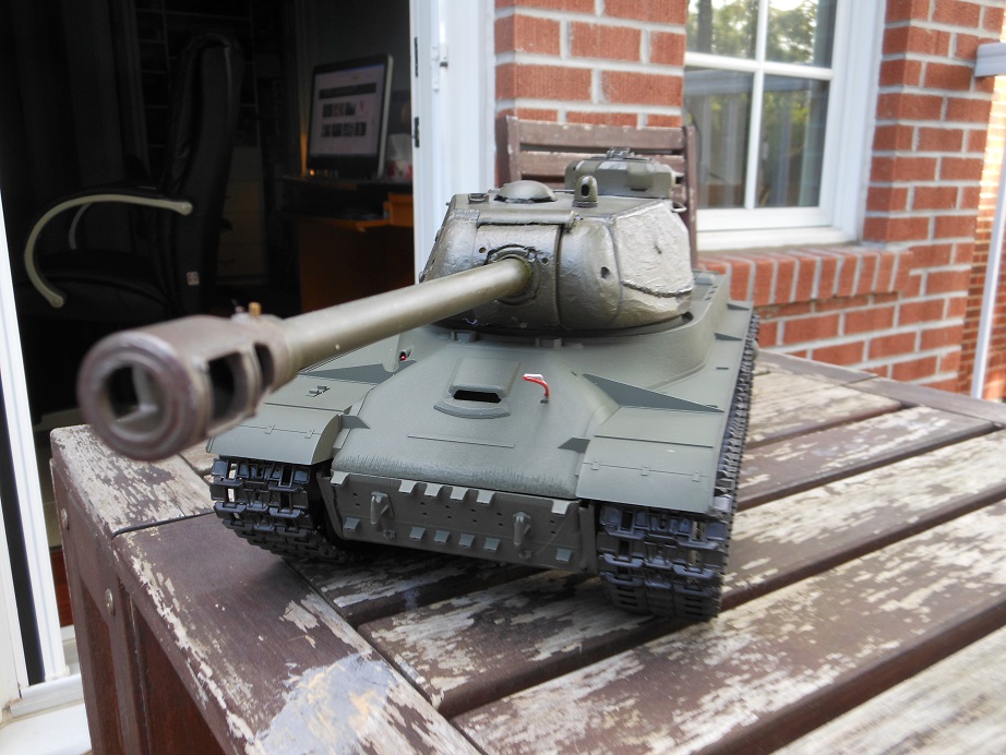

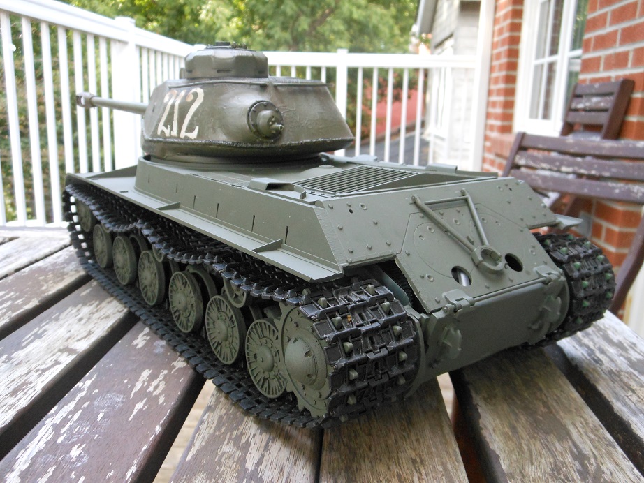

I have a poor man's JS-2 using Heng Long KV lower with suspension mod, wheel covers from Junkenburg's JS-3 kit, upper from Tamiya and the turret is a mod Juckenburg KV-85 with a 122mm barrel as an early JS-2. Not pretty, and almost as much as a Tamiya at the end, but just can't see myself paying close to $2,000 CAD for a full option kit.

Re: Anybody tackled a scratch built JS2?
The result looks pretty impressive Michael, nice looking tank.

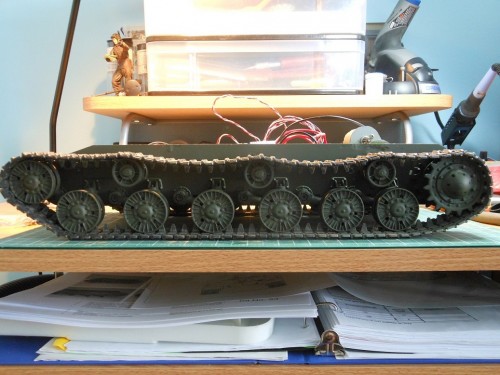

Thanks guys....... The suspension mod is actually from Mr. Junkenburg, as he sells the JS-3 kit that uses a HL KV chassis. Basically what you do is put a piece of square styrene into the bogie wheel travel, so this will lower the actual chassis and reduce the wheel travel, but gives you the desire look of the IS chassis. Here is a mod HL KV chassis, with the return roller relocated to between bogies, spacer into all the bogies travel, and JS wheel covers on all of them including the sprockets and idlers.

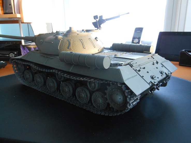

The effect is quite convincing but you lose suspension travel. Here is a better picture of what it looks like on a tank (In this case the JS-3 but the JS-2 is identical in terms of the lower)

I'd never noticed the different in stance height between the KV and IS, and it's actually pretty striking. Nice work on the suspension mod, it definitely looks the part.MichaelC wrote:Basically what you do is put a piece of square styrene into the bogie wheel travel, so this will lower the actual chassis and reduce the wheel travel, but gives you the desire look of the IS chassis. Here is a mod HL KV chassis, with the return roller relocated to between bogies, spacer into all the bogies travel, and JS wheel covers on all of them including the sprockets and idlers.
