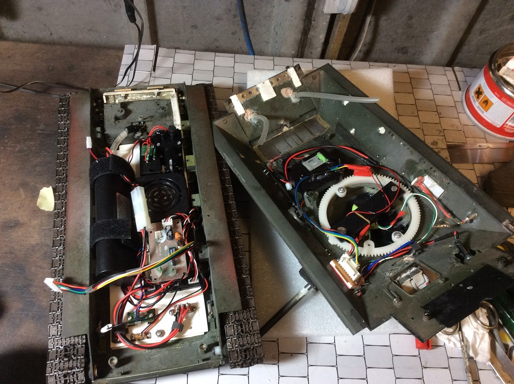

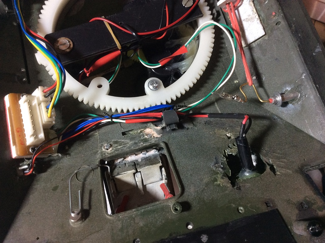

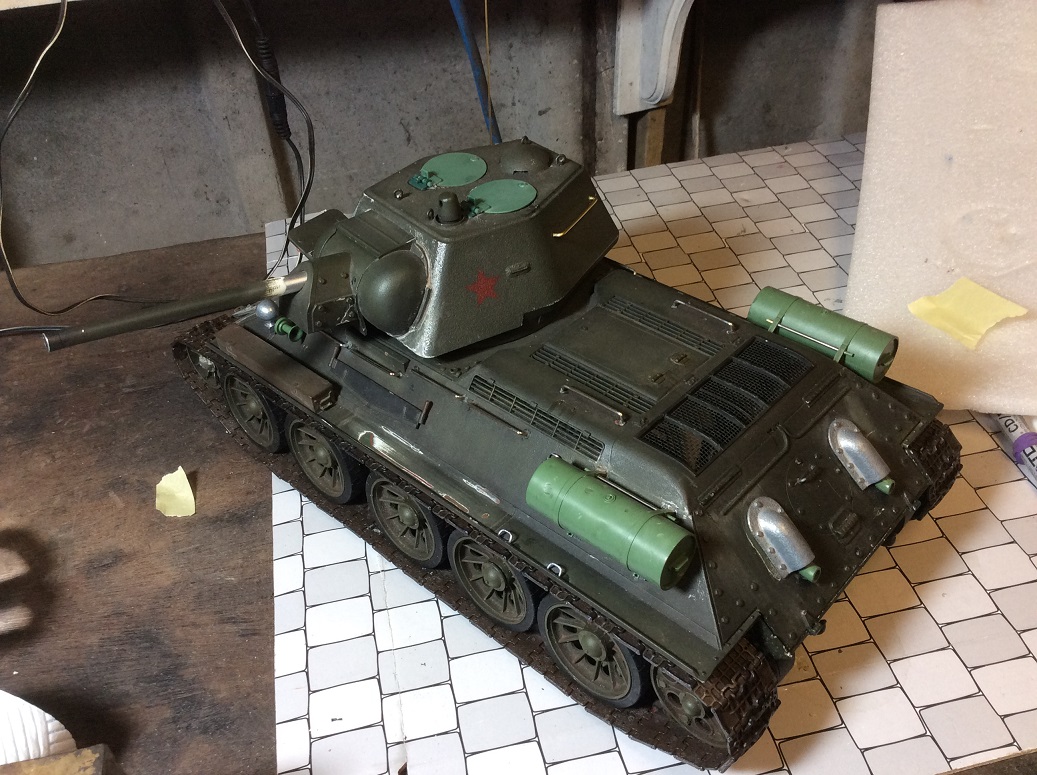

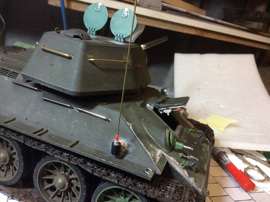

This is my first project, I have been working on rebuilding and modifying a mix of parts to produce a T34 1943 model with hex turret. I have been taking pics during the build and I am just getting to the painting stage. The lower hull is WSN Torro, the upper hull is Trumpeter, the turret is a resin hex turret, the electronics are hengLong TXRX18. As a first project I thought I start with something easier, using the HengLong electronics and following the example of other people on this forum to learn the basics before doing something more advanced. The metal parts and other electronic components were supplied by Forgebear. Tank has smoke unit fitted, barrel has flash which works with the K button mod, I fitted two led mg to turret and hull, fitted metal grab rails and other components, made turret and driver hutch open using magnet locking to hold open. Antenna is made to swing up and down when the turret traverses using elastic band which works well. Lots of small metal parts for added strength and suspension has been beefed up etc. Made the internal components removable on a tray for easy maintenance. Magnet locking to hold upper and lower hull on. Thanks to all the other builders whose ideas I have used and for all the help, you know who you are. I post pics later when finished and painted.

Lovely and I like the clever solutions like the rubberband for the antenna base and the paperclip hinge for the driver's hatch.

Thanks guys for the comments, I enjoyed working on it and learned a lot. A big thank you goes to Michael and Del, Dave (forgebear) and many others on this forum for info, it is appreciated. The resin hex turret came with it when I bought it as a project, I rebuilt the mantlet and barrel as it was off centre and fitted the elevation unit, mg and flash inside, turret hatches are from a t34/85 and are too large, so were filed down and fitted. I hope to fit servo recoil one day and a new system as the turret is too small for the usual ready made recoil systems, not much space in this turret. Yes, fitted magnets to engine rear to hold hull upper on, fitted flange on front plate so it hooks on at front and clips down at rear with magnets.

If you at the picture of the hull back you will notice a strip of meccano welded down with white plastic strips to the rear upper hull, that is the steel contact, on the lower hull are two powerful magnets, with recessed holes for screws in them I got from ebay. They are fixed to a bracket which fits flush to the outer hull when closed and having screws, the magnet wont pull off or need glue and I made them adjustable by backing them with rubber spacers so you can adjust the fit for a perfect joint by tightening the magnet holding screws etc. The front has that plastic lip fitted and another two small round magnets fitted in the hole that the old screw posts make, iron screws to upper screw posts and that gives even more magnetic contact. It all holds on super tight, quite hard to pull it open but easy for battery change and smoker top up, repair, no screw driver needed to get inside.
