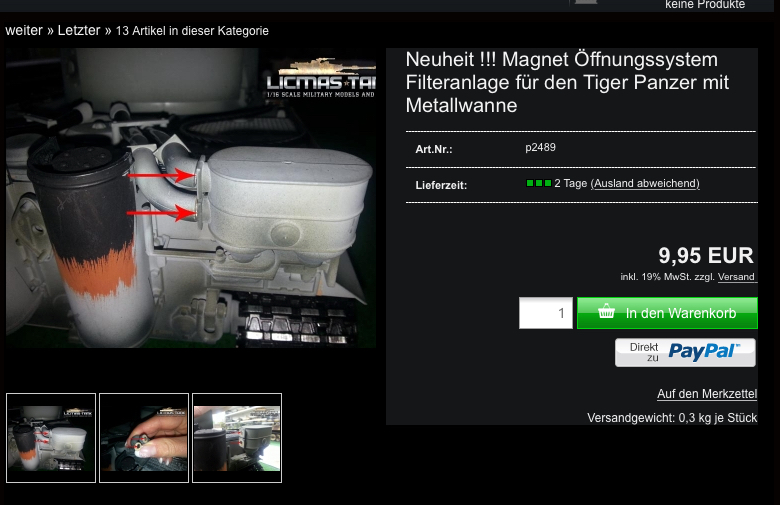

Like Jake, Carl, I'd be interested to see pics of where, and how, you positioned your magnets :) I use the Taigen locking system kit on my tanks (available from rctank.de, and elsewhere, at a reasonable price.) However, I used 8x2mm magnets to secure the Feifel air duct hoses with some success. I got that idea back in 2015 from Licmas Tank (though other threads here made reference to it); but never employed it
as a hull retention device. I'm still contemplating a method with hinges and magnets..but that's in La La Land for the moment.
Here's the Feifel link: https://heng-long-panzer.de/de/ZUBEHOeR ... wanne.html
There's also a Youtube clip of the magnets in place. It could be a useful adjunct to an early Tiger 1 build, as it's a pain having to undo the Feifel bits to get the upper hull off.
Shaun, thanks for that attractive site. I missed that one back then... :wave:
