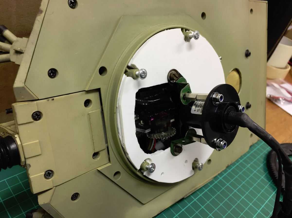

First off was the fitting of 360 slip ring. This is version 1, before any thought to elevation and recoil.
Nice and neat, and ready for a QD plug to the hull
Of course, it was all so simple. Plenty of capacity for everything that was going into the turret, and a nice meaty feel and heft to the slip ring - made from unobtanium and built to last. Slip ring plum dead centre in Turret, What could possibly go wrong?

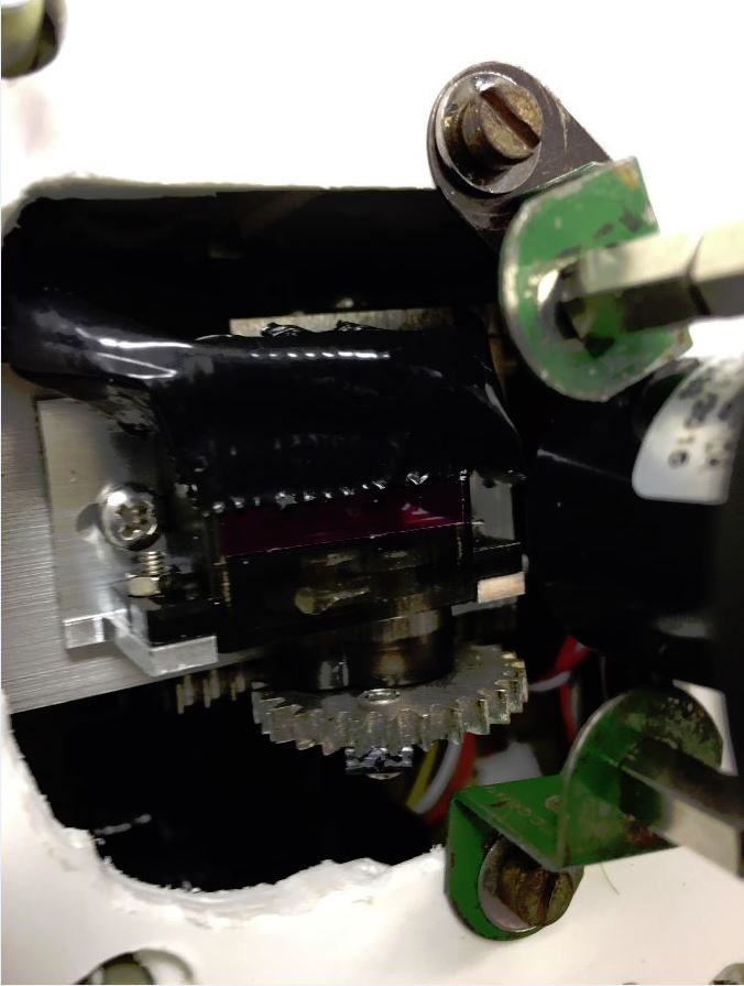

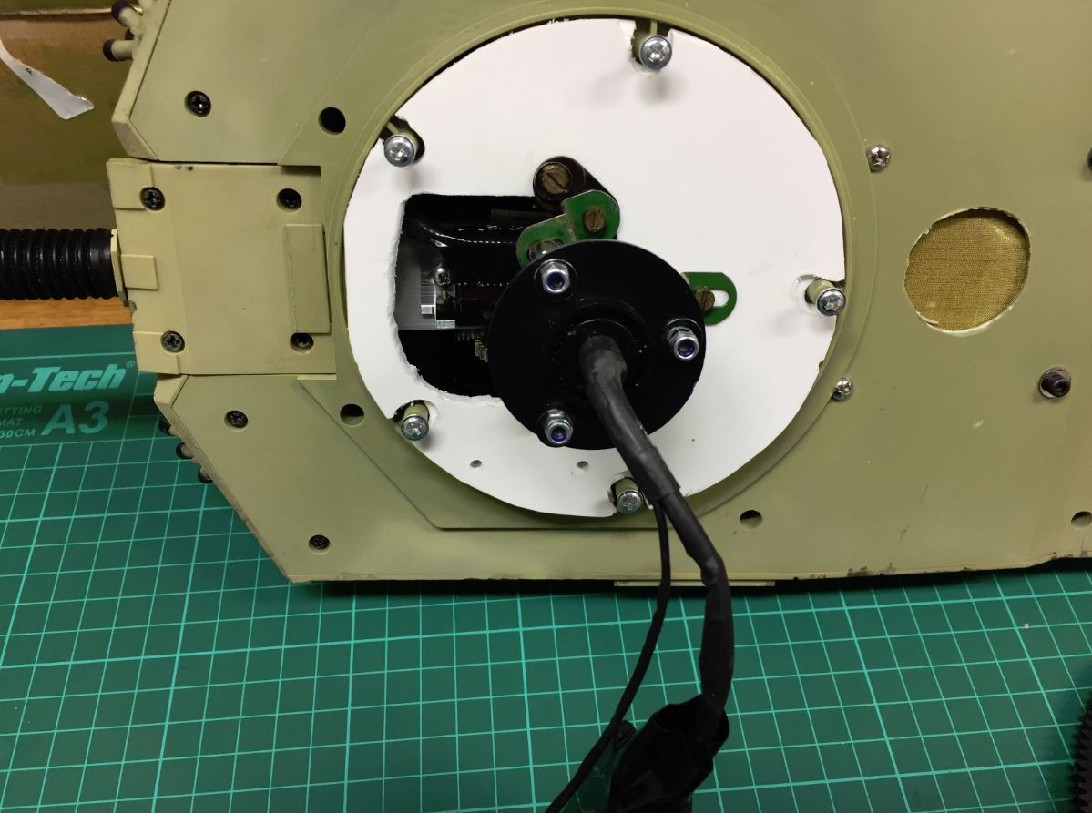

Well, the bits from Carson at DKLM arrived and quickly demonstrated that there was insufficient room to provide the desired elevation. I will post pics of the Chassis in the next build log, so for now we will stay on topic and see how we met the challenge of coping with the elevation and recoil.
Rather than live with limited elevation, it was out with the Dremel and assorted bits of Meccano. Here's the result:
"modified" to allow greater Elevation
Somewhat over-engineered methinks
That's genuine Meccano, and after much cursing and measuring and remeasuring is pretty central in the Turret. Pretty will not quite do, as we will find out in the next installment. As Flies to wanton boys, are we to the Gods. They kill us for their sport.
It all looks so simple. Should probably have got one from Dave.....
Slip ring v2 detail.JPG (63.96 KiB) Viewed 8534 times
That was a couple of weekend's work - in between dog walking, Dad's taxi. V1 was created in November, and v2 in the second week of December, so you can see this build is moving at a glacial rate.

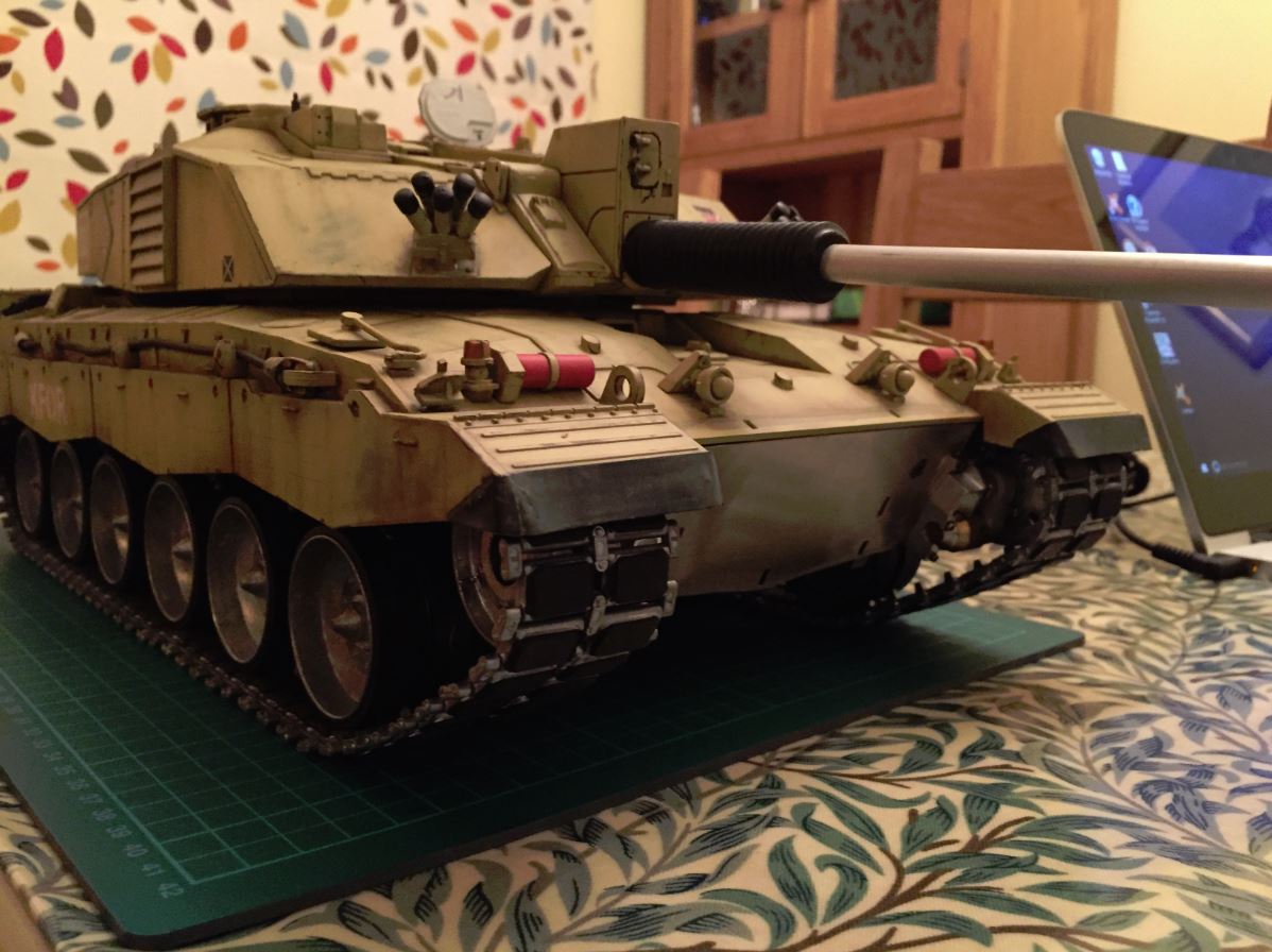

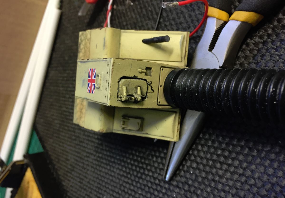

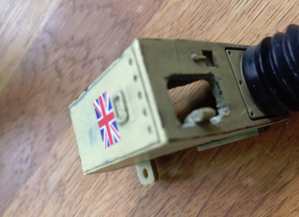

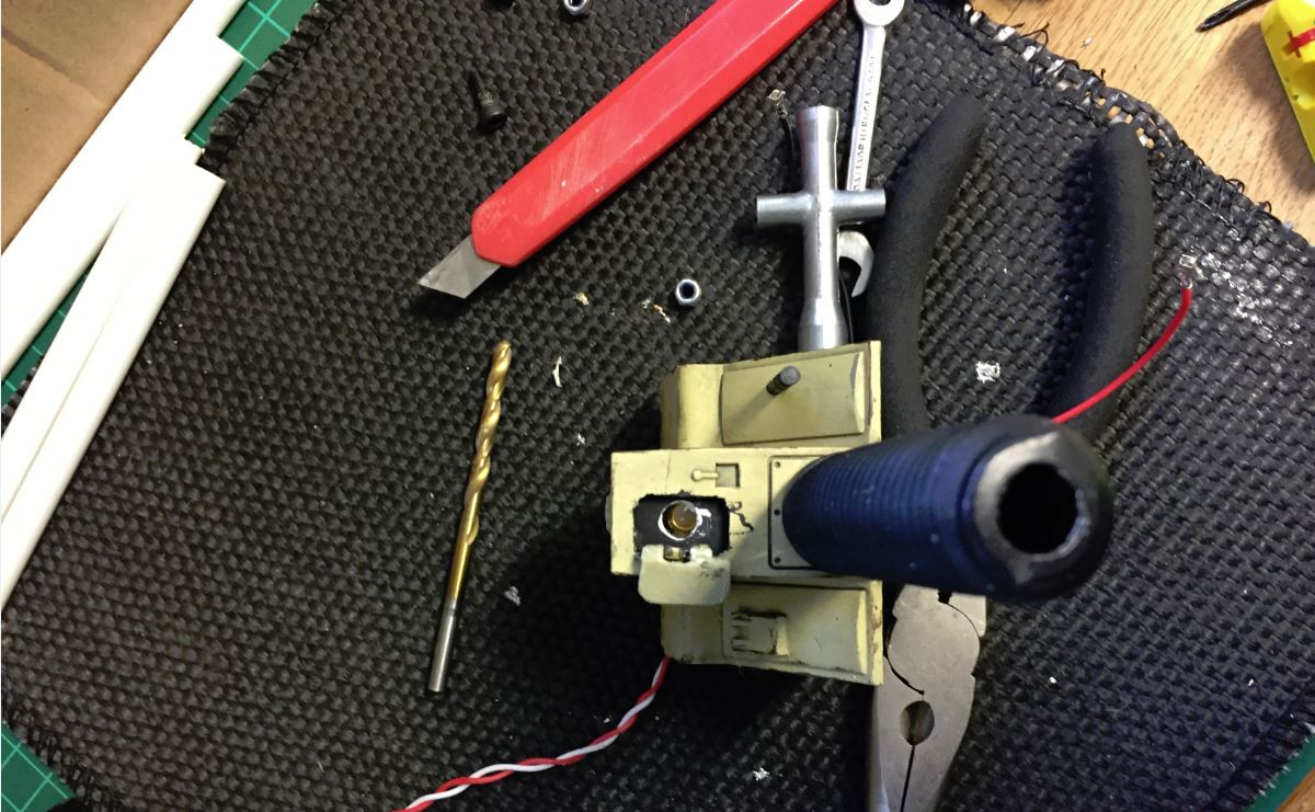

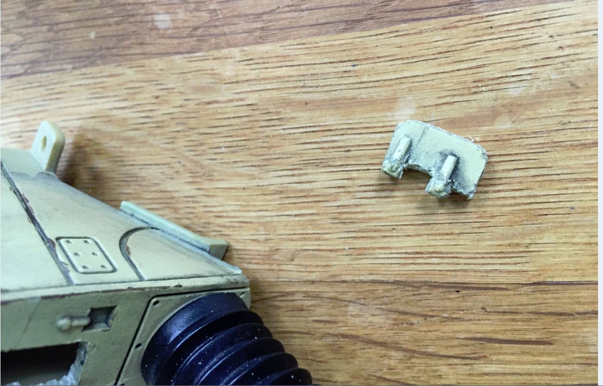

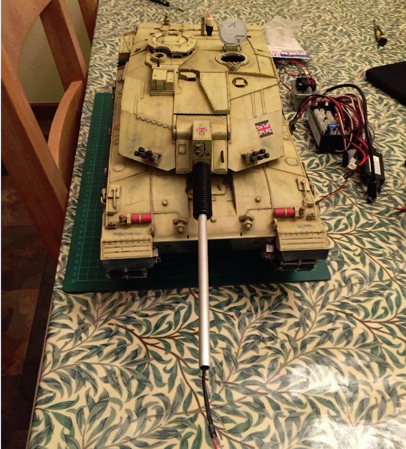

I had earlier "had a go" at the TOG. Having realised that the HL/Taigen Xenon I had licking around (another story - my Befehls Tiger was lunching Recoils for fun at one point......) did not emit IR, I was determined to put this right. The TOG is an obvious place to put it, even if I now wonder at the effort expended. Following Shaun's advice elsewhere, I duly purchased a pin vise which came with (insufficient in my ham-fisted hands) drlll bits. Anyway, I managed, eventually to cut out the "door" and surprised myself by managing to make a hinge using the remnants of one of he (many) broken bits:
TOG with door cut out
Not bad - did not require too much finishing
TOG with door fitted

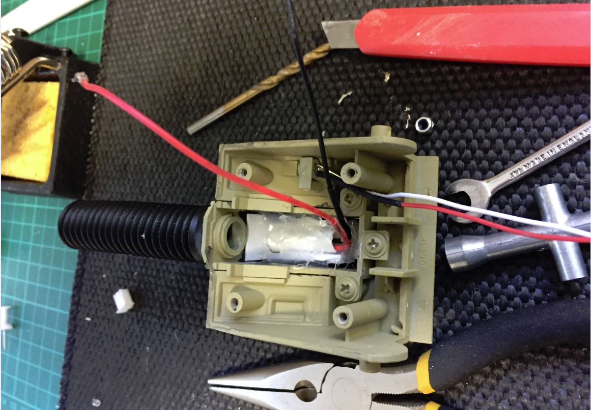

Detail showing tube holding emitter in TOG
Now with emitter fitted
I know you are asking where the bellows came from. My mate Andy cannibalised an old woodworking Router machine. He has no idea of its provenance, merely that it was sat in his "shed of wonders". Sorry.
Anyway, that's it for this installment.

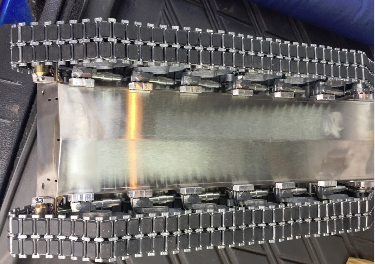

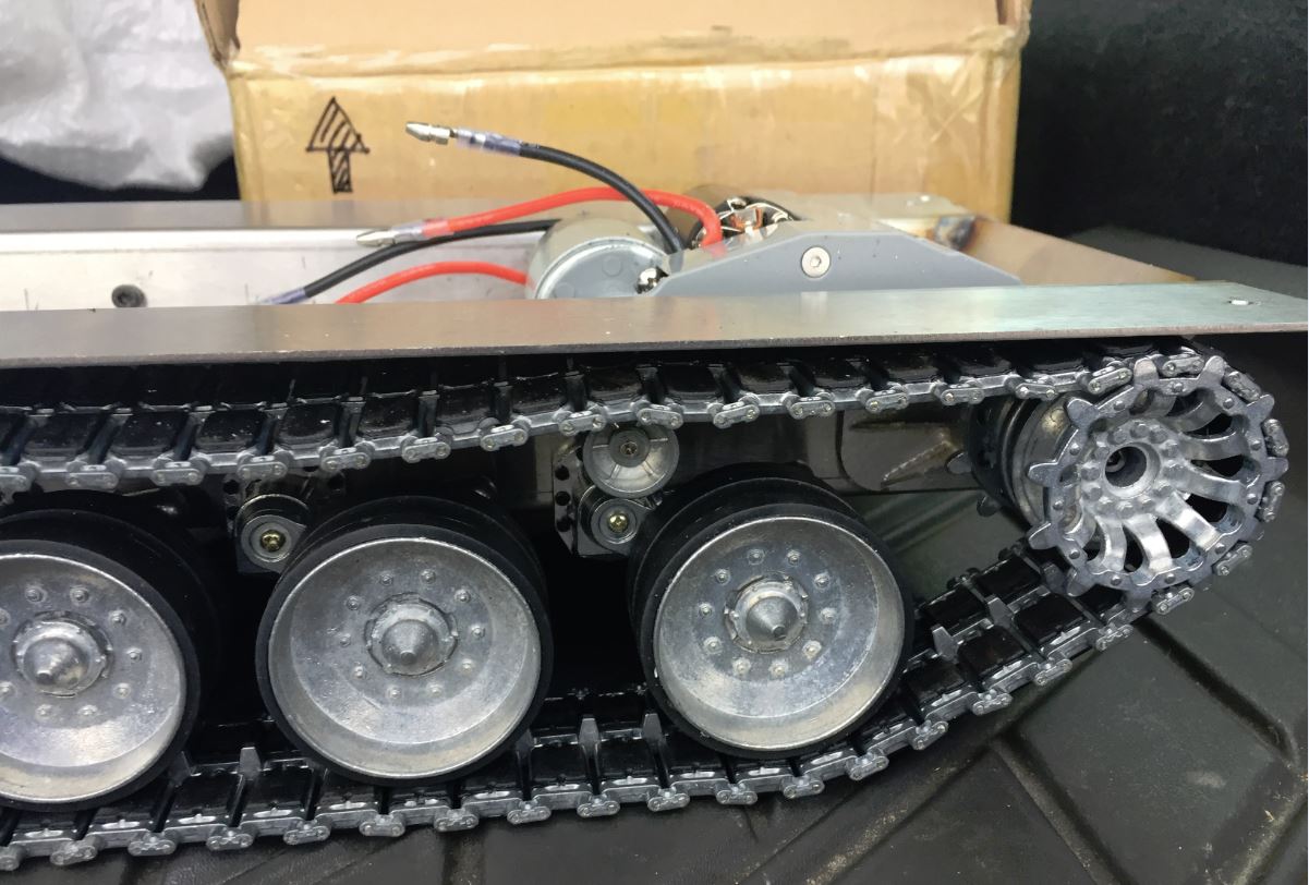

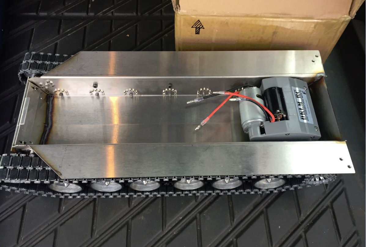

I think I left off yesterday, with the promise of a spot on the DKLM Chassis. Mine arrived in the last week of November. Carson was, as ever, splendid - he had warned me when I ordered that there would be a delay as the workshop were busy doing other things. I actually had to collect the parcel from the Parcelforce depot, as there were the dreaded fees to pay. Since the lady who answered the bell was of pleasant demeanor, and I wanted to borrow some scissors to open the package, I decided against arguing that since I had had to collect the parcel a discount was due. Paid up and looked happy.
Next stop the NEC to meet a mate at the Bike Show. I was early so had ample opportunity to have a look in the boot of the car. First impressions - beauty to the beholder. Second impressions were painful - literally as I now had a number of paper-cut digits. Thankfully it was cold. It did add a job to the ever expanding list; clean up the edges. Pics:
Front section
Front section
Rear of chassis prior to application of paper-cuts
View of chassis from above
Underside of hull - lovely

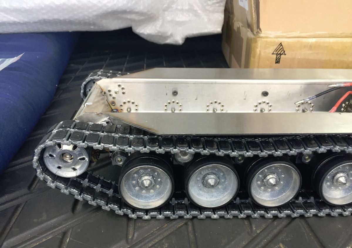

So bike show duly done, the following day afforded the briefest of looks - more football, dog walking, ferrying neice to stables; a waste of Tank time, but sometimes idleness has its place in life. Hmmm, perhaps I got a bad one? The fit of the rear panel was certainly not plug and play. Email to Carson revealed that a certain amount of DIY would be required. Not easy drilling Stainless - for that is what the chassis is made of. Of course it helps if you take a little more care of ABS panel parts in the first place. What sort of idiot places said item on top of a tall box, still affixed to the old HL chassis, then swings their Black and Decker workbench into the box? This one apparently. Well, it needed a bit of modification anyway, so let's just add that to the list shall we?

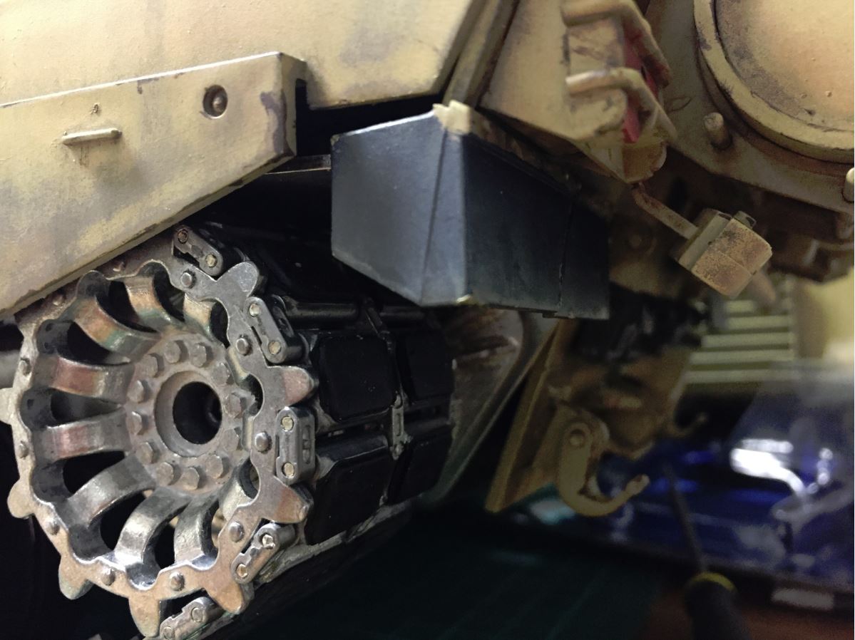

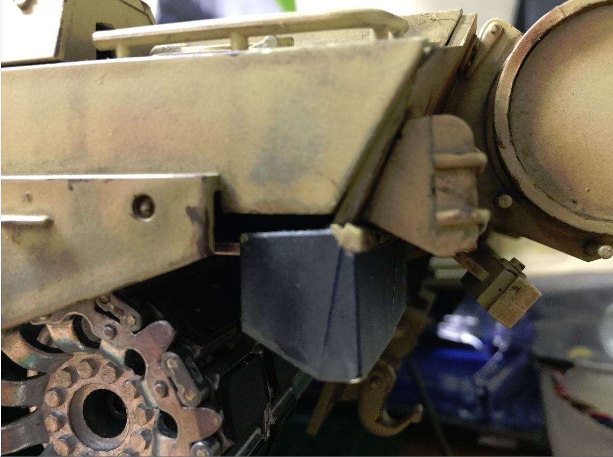

Anyway a few pics of the quandary I found myself in in the first test fit:
Front not lining up with rear panel fitted as HL designed
DKLM Chassis first fit.JPG (96.5 KiB) Viewed 8478 times
Another shot of rear panel gap
Rear Panel fit prior to modification
I slept on it (for a week or so actually - again others had decided there were better things to do in my spare time) before returning Dremel and flat file in hand. Seems you have to remove all trace of any material from the rear of the HL panel, plus trim a smidgen off the sides. Then the panel will slide sweetly between the "spurs" which project at the rear of the DKLM chassis. Once completed, the fit is pretty good. I didn't want to perma-fix the upper and lowers, and the simple use of magnets is hindered by the DKLM being Stainless. I have a cunning plan, involving magnetic strip and Neo magnets attached to the remaining HL posts (2 towards the rear need to be removed entirely to clear the DKLM gearbox units), but other challenges have added to the joy so that task remains, as I write mid-January. Hey-ho.

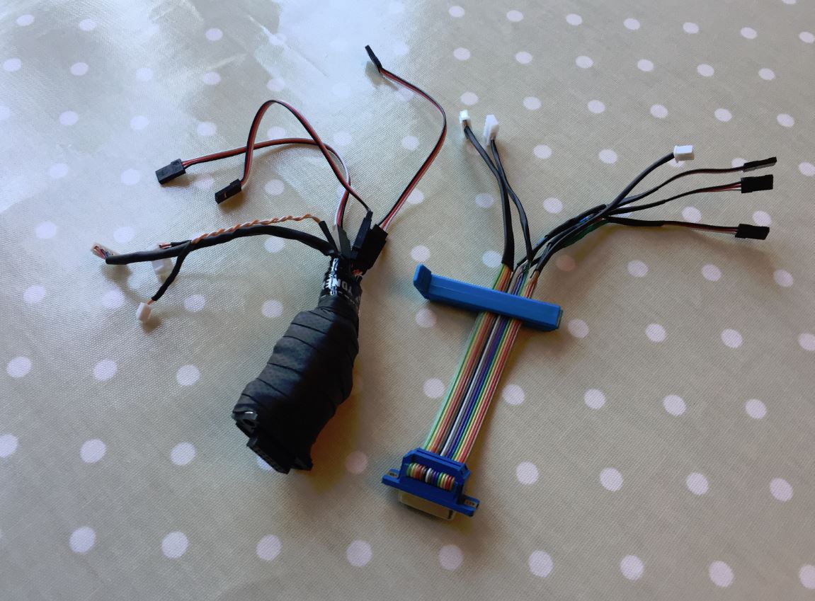

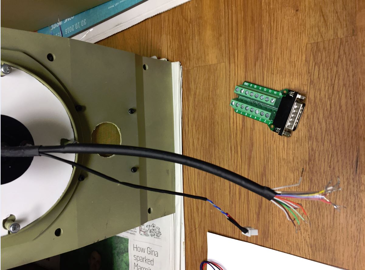

I promised I would do a section on wiring - so that some may learn from my mistakes.......
From the off, and wishing to improve on some of the shortcomings on my Befehls Tiger, I wanted to have some form of quickly detachable Upper and Lower. To whit, a means of avoiding pulling multiple JST connectors apart every time I needed access.There are 18 wires going in to the Chally Turret - 2 of which go straight to the HL multi-port connector in the Upper hull.
That left 16 - and I calculated I needed 15 to go to the IBU3.

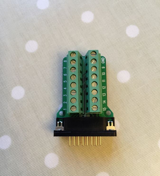

There are plenty of connectors available, but an awful lot are made to either cater for thick wires (16AWG minimum I would think) or require an electron microscope and the deftness of a Brain Surgeon to solder. I posses neither.
I elected to use a DSUB DA15 connector as per the attached:
DSUB solderless connector
DSUB connector.JPG (84.62 KiB) Viewed 8396 times
Perfect, I thought - when I mess this up, which I will surely do, at least I can use a screw driver to sort it out. The only problem is that I was somewhat space constrained. For whilst the DKLM chassis looks to have plenty of room, some idiot had built an enormous superstructure to hold the Slip Ring. Being that idiot, I found to my cost that my initial planned layout - IBU board at front, battery somewhere aft of that, and the TARR near the exhausts, was going to be a challenge.

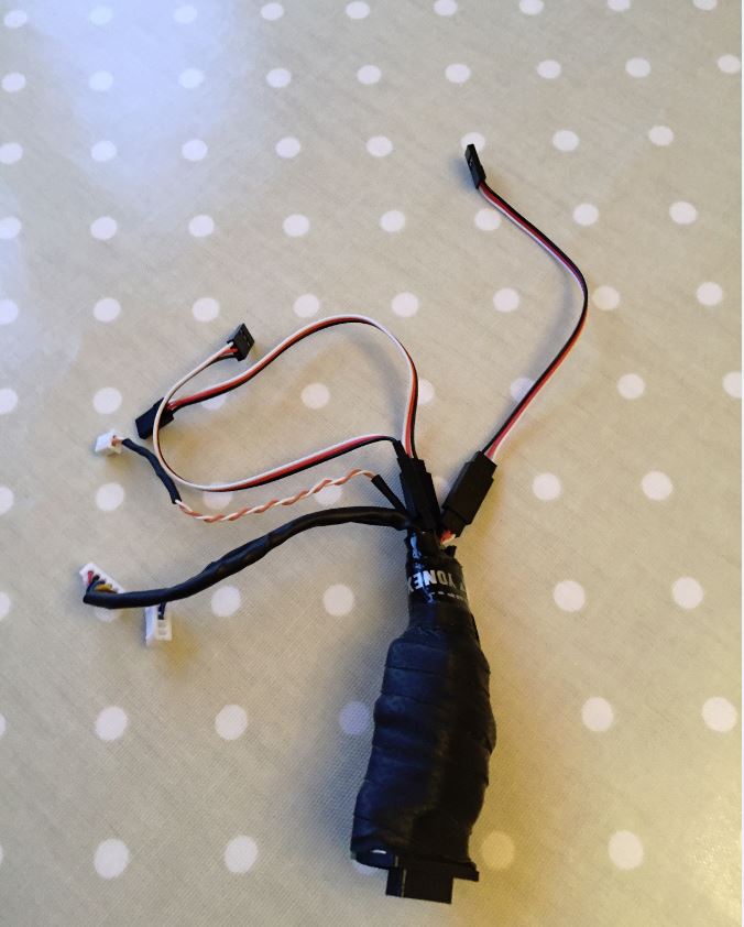

regardless, I built a harness for the Slip Ring to IBU3. Here it is:
DSUB IBU harness v1
DSUB IBU harness v1
DSUB v1.JPG (70.24 KiB) Viewed 8396 times
It worked, but required much manipulation to get the upper hull seated and Turret to rotate without fouling something.

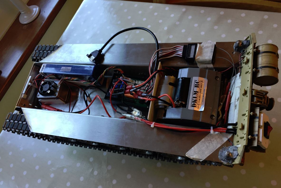

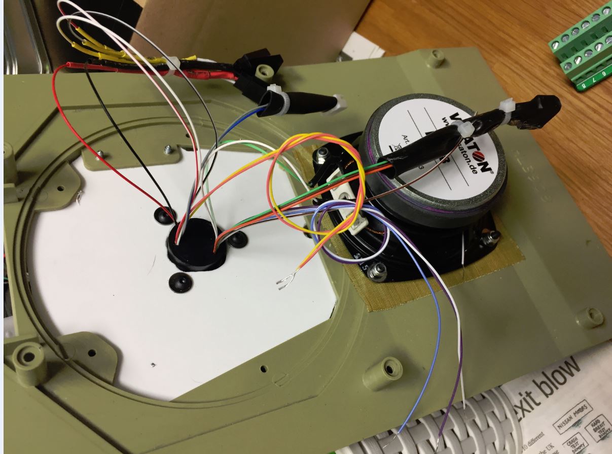

This is the "only" internal gear layout that will fit with the Iceberg slip ring gubbins:
Only internal layout which works due to slip ring
Of course, anyone of sound mind at this stage would probably have lived with a compromised Elevation and ditched the Iceberg. Be polite and call me obstinate.

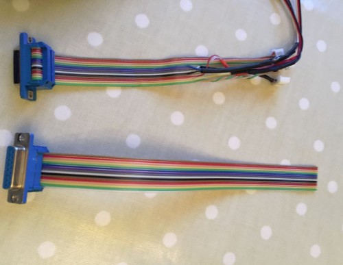

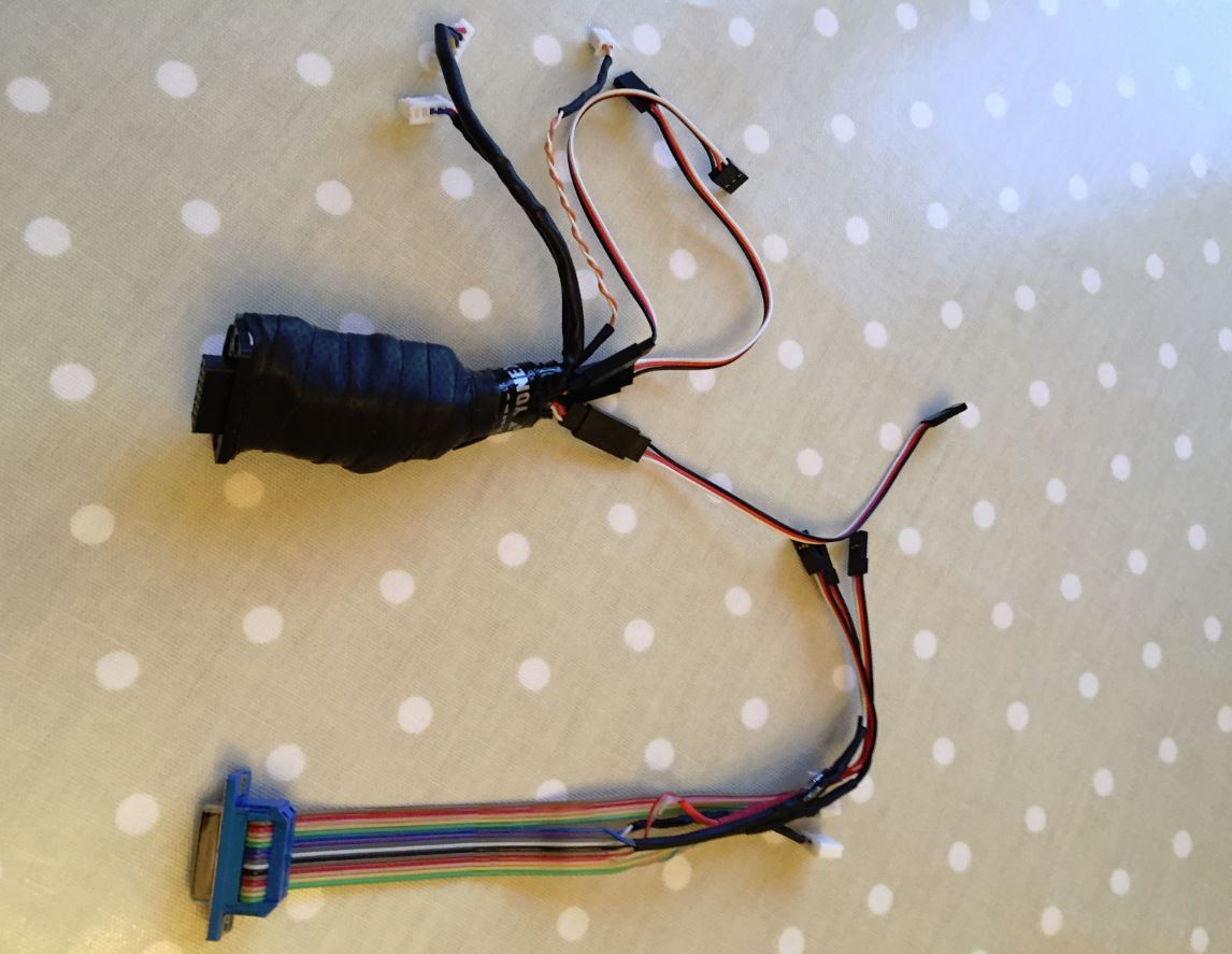

I decided that I needed to put the DSUB on a diet instead (I had already abandoned the beautifully crafted 8 Pin DIN cable with central connector, as the cable was thick enough for Transatlantic cable work - I cry to look at it even now, just thinking of the sheer number of JST crimps sacrificed to get it all working). A (long) trawl on the net revealed a potential solution - IDC (insulation displacement connection) DSUB and Ribbon cable. Despite being kept awake even now of memories of being stranded at the roadside on 250cc bikes "upgraded" with air horns using cr@p blue snap connectors (actually that is a lie, it usually thinking of the horrendous cost per mile of running a Laverda 500 in the 80's that does that), it has actually worked very well. Well not version 1 obviously.
Despite having looked at the DSUB and noting that the 2 rows probably resulted in a pattern of 1,3,5,7,9,11,13 and 15 on the top, evens on the bottom, I believed what I found in the TinTintnet, and managed to reverse the order. As a consequence nothing, unless it was connected to the HL 8 pin, worked.
DSUB on diet. Diet proven to work, wiring didn't
Out with the multi-meter (why didn't I do that in the first place before spending forever tinning then crimping?) and a few choice words, I realised that this was not going to be a simple case of deftly plucking JST's out of their white plug, it was the start of Groundhog Day. So I left it for a few days and made another one. I also used branded JST parts rather than the ones from FleaBay I had used early. OMG what a difference. Only 1 casualty out of 10 - and that was because I had got annoyed after it "found its way" into the wrong slot in the plug and I was less than tender getting it out again (actually truth be known I was also too lazy to find a proper pin to push down the tab, and was using a screwdriver that was to hand).
Net result - everything working and the hull is far less of a struggle to fit:
DSUB fail and DSUB with unmolested ribbon
Final DSB with original prior to Weightwatchers

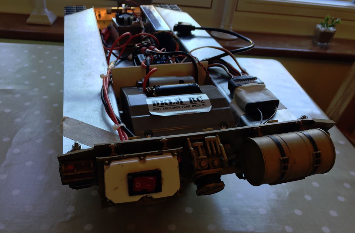

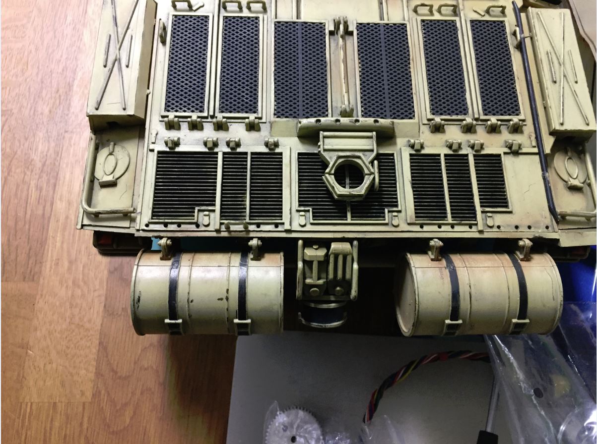

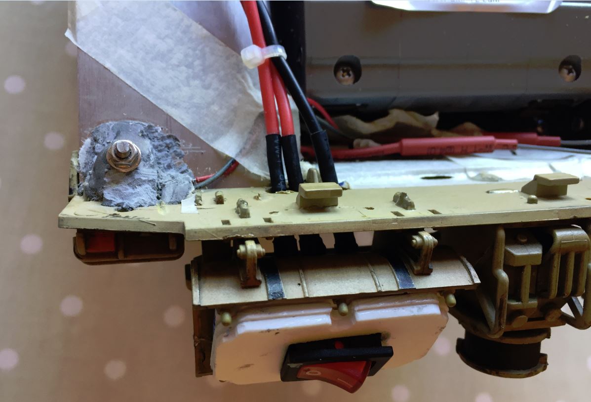

Final task in the wiring was to copy other Forum members and put the on/off switch in the fuel drum. Since this has been done before, it was relatively straight forward - see I can copy. Oh, and I learned how to solder HXT Bananas, which was fiddly. I found my "helping hand" would shoot the wretched thing across the room (allowed to do stuff in the Utility room by this time - probably only because I could be called upon to break up fights over PS4/who made that mark/who did or didn't flush the loo. You can't do that if you are in the garage. I prefer the garage ;) )when applying any lateral pressure whilst cooking the Solder in the cup. That meant it took longer than hoped to tidy up when called to tea. Pretty sure I would be back in the garage if it was known that "hot works" wree being undertaken without a permit. Anyway, for what it is worth, here is an On/Off switch:
Long shot of On/Off
Long shot of On/Off
Chally on off switch far.JPG (99.5 KiB) Viewed 8396 times
It is a switch, but I like it
