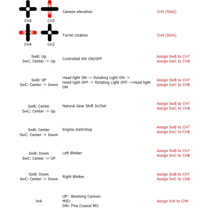

It'll be based on channel mixing and using different parts of the same channel. You can have the receiver read a particular position in a channel as an output, think along the lines of the different positions the ignition key in your car has: channel 0%: off (key off), channel 50%: on (engine on), channel 100%: start (engine ignition). That's one channel giving you three states from very basic mixing.T9FURY wrote:Now I know the two sticks are 4 channels with channels 1 & 2 on the right stick and channels 3 &4 on the left stick, I was also under the impression that any buttons on the TX are also channels, so in aircraft terms the the sticks control the throttle, ailerons, elevator and rudder, then you might have a 2-way switch for the flaps up and down, you might have another 2-way switch for bomb bay doors.

Are these actually classed as channels? Some of them only control the sounds, but if you look at the shoot button, it fires the main gun which is the same function as the left stick (forward), so is this button a channel or is it just wired / linked internally to the same channel as the left stick?
Take a look at some of the convoluted stick combinations the Clark boards use for different features, it'll give you an idea of how much information you can extract from a relatively small amount of transmitted data.
None of them will be compatible with the RX18, unfortunately. The Heng Long system is proprietary, with the receiver embedded in the electronics.T9FURY wrote:Also I need to bear in mind if any of these will NOT be compatible with the Clark TK60G2, although it would be nice to have it compatible with the original RX-18 system my priority will be all the new gubbins I am installing. Also, if I get more tanks and want to do all the binding thingy ma jig, I will buy more receivers for that particular TX.
You should be alright with basically any of the radios you've been looking at, from what I understand (not having used one myself) the Clark boards are expandable with more and more channels freeing up more controls. You probably won't be able to go wrong.

No. Like I said earlier, you don't need a separate channel to act as a switch. Take a look at the Clark controls for use with four channels:T9FURY wrote:But my original question still stands though.
From what I read in an article all the buttons on a remote constitute auxiliary channels, so if you have 2 sticks, with 4 buttons / switches then it will be an 8 channel radio. So going by that theory the RX-18 TX would be a 9 channel
