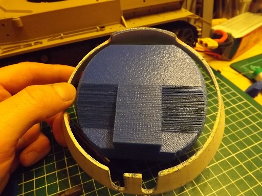

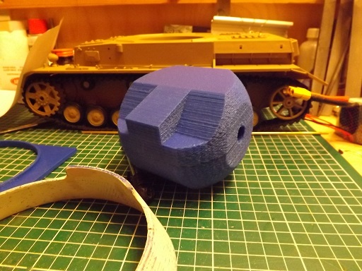

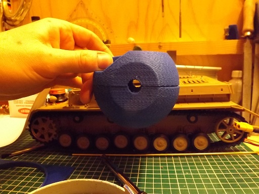

OK, for some reason I can't upload picture from my phone. But I've printed too and bottom halves of the turret ball not detailed but the basic shape and I think it may need to be a mill or 2 bigger as the fan around the outer turret looks a smidgen big.
I've also skimmed and sanded the outer turret so it's smooth and level.
I'll try to get some pictures up this weekend

Re: kugelblitz
i have been at work on the kugel but also spending a lot of time just staring at it.
printed a replacement top deck to take the turret as it dips into the hull. i may have to print the final one a mill or 2 wider to get the right gap between the inner and outer turret, the outer is skimmed and sanded and im pretty happy with that for now. before i do any more im goint to order a shaft ad a pair of bushes to support the turret.
