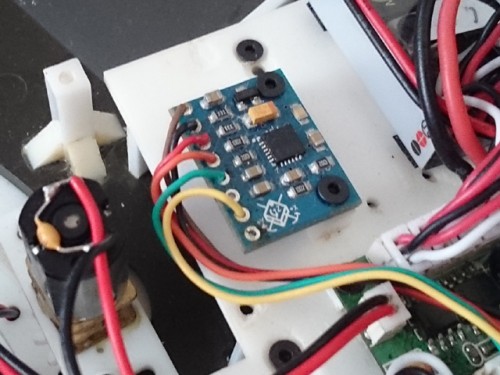

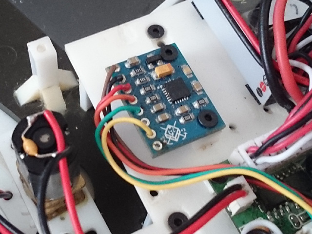

Here is a little info on the Clark TK60 ( latestet Board after the TK24) since it was mentioned .
the different between the tk22-24 and the 60 is first of all huge step up in the sound Department.
from 1,13 you can hear the lates sound for the Challenger 2 ( on my home made speaker Box)
Also the G2 vers of the card now have Gun Barrel Stabilizer ability.
Atm I Stock only the TK60 ( not the G2)
other features mentioned is the 'revup' ( tank standstill )
is has a 15w onboard amp
Support air-soft gun with sound synchronization
Support TAMIYA 1/16,  TAMIYA 1/35, VStank and HL IR battle unit and format
Support RealRecoil servo port
Support elevation servo port Support gun barrel stabilizer
Safety shutoff prevents unwanted movement while signal lost Auto R/C signal detection
Support 3S Li-Po battery
Miniature design(92mm X 52.3mm X 25mm)
It's not a 100% plugg and play , some wires moving is required , if inteded to use in tamiya etc.
