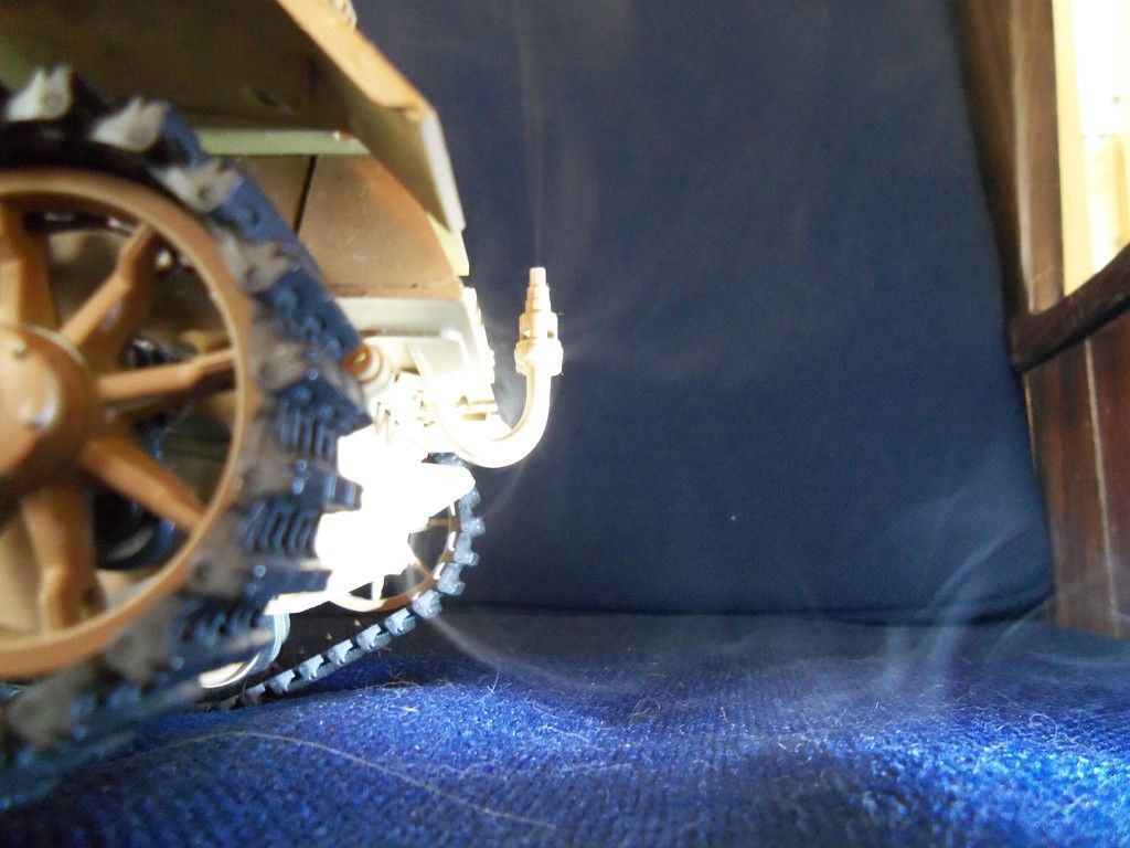

First, a 3/16 bore on a brake line is huge. Standard brake tubing in the US has a 3/16 Outside Diameter and about .118 to .125 for an ID. But, Jack is right that a standard tubing bender of the type he describes is very cheap and can be used for a variety of tubing sizes. If you're using it for 2mm I would determine the inside diameter of the tube and then insert a piece of styrene rod the same size (just slightly smaller actually) that will give extra support as you bend and the rod should slide right out afterwards, especially if you shot a tiny bit of lube in there before you inserted the rod.
But remember, it's always best to use the right tool for the job, and that's why I bought a $10 bender at the local hobby shop, and that's what put the bend in this exhaust, which is made from brass tubing.
