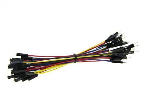

Directly connecting wires works so long as they're the correct wires. Where two wires share a common connection...you might have a problem. What I do for experimental purposes is use these, as they're an easy bridge between existing connectors. and don't involve dismantling the JSTs. (Hard if you're cack- handed). You'll find them in OZ at: http://www.pakronics.com.au/collections ... and-probes
Best of luck, mate and belated HNYs..
I almost turned into an icy human stalagmite. Lots of that deep white powdery stuff (not the sort that goes on dollar bills up the nose
instruction code) embedded in the Taigen unit differs from that in the Standard HL unit, and the HL t-90 unit. The T-90 should trigger the airsoft, and sound but will not trigger the recoil. You need an IBU for that. Even the Clark TK22 (I discovered to my dismay) couldn't operate the Taigen Airsoft Barrel Recoil System.
Trial and error connections can be a problem with circuits containing diodes (i.e an LED). Diodes are polarity dependent, and can blow with reversed wiring. Ordinary +/- switches are ok..the worst you can do there is make the component run backwards (elevation unit, rotation unit etc.).

- 1 pin Female-male jst jumper wire.jpg (10.91 KiB) Viewed 2773 times
