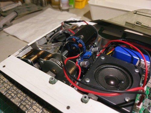

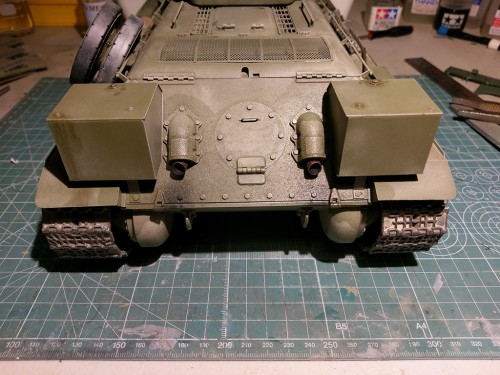

I've mentioned a before that I've had a number of problems with my Tarr smoker. At this point, I've spliced in a DC step-up regulator, connected it directly to a LiPo battery, switched to Mega Steam and the smoke output is still sporadic and weak. It seems to periodically condense near the entry of the tubes and block them off, until they leak out the other end. Consequently, the entire rear of the tank was soaked in smoke fluid after ten minutes' or so of runtime.

Am I doing something wrong, or have I got a dud smoke unit? I'm really unimpressed with this thing and don't see the appeal at all.
I'm trying to blot the oil off the tank right now, and I'm hoping it hasn't ruined the paint or weathering. Knowing my luck, I'm going to have to redo half of it.

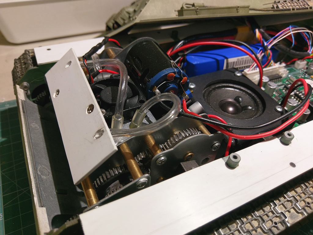

dgsselkirk wrote:Can I see the inside set up you have?
I've wired up a direct line from the battery to the voltage step-up (the blue circuit board between the speaker and motor), which feeds the heater coil. The fan is controlled proportionally by the IBU2.
The tubing is looped around to give a wider bend radius to prevent kinking, and I've got a length of strong antenna wire to hold the shape and make sure it doesn't collapse in on itself. It looks like I'm getting a decent 3 millimetres inside diameter the whole length of both runs.
With the coil cranked to ~11 volts, about four pipettes' worth of Mega Steam and the fan pushed to 100% speed, I still get smoke fluid condensing in the tube inlets (where they come out of the smoker). I ran it under the rangehood in the kitchen so I could watch, and it doesn't behave anything like the one in your YouTube video (which, incidentally, I saw last year and helped convince me to buy the damned thing!); I'm not sure what's different or what I'm doing wrong.

The pipes look fine,when i ran mine at 12v it produced too much smoke so i'd say check the heating element or wick as sugested.

Pipes look good but 4 doses of Mega Steam is too much. The most I ever put in is 2 and that is enough for 1/2 hour run time no problem.
You may be saturating the batting inside too much. How long have you let this run please? Let it run for 1/2 an hour. if you don't see an improvement in the smoke it may be the element. Although everyone says no problem to run at 11 V I know the manufacturer does not vouch for it running at that voltage...

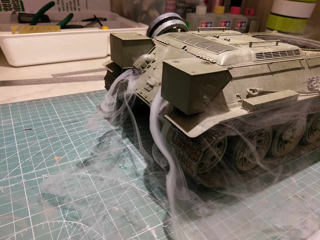

Thanks Selkirk and Kiaser, you were both correct; the Tarr was overfilled and the voltage regulator was being interfered with.
I drained the unit and refilled it with only one pipette full of fluid, and while the performance was better it was still recondensing in the tubes. I checked the voltage coming out of the step-up and it was only reading 7.2V (less than the battery!). Since I set the voltage before I installed it into the tank, it looks like the magnets in the motor altered the dynamic of the voltage change. As soon as I adjusted it back up to 10V the smoke started pouring out of the thing:
Works like a charm, now! In the space of about twenty minutes running, I only had two blockages in the tube inlets and they both resolved themselves in a few seconds.
