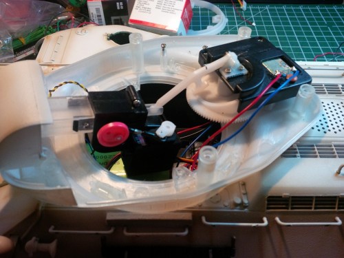

I have a WSN T34 which ha been fitted with a Clark T22 Board. I understand that I need to fit a servo to enable the recoil, rather than use the existing. I found a post back in 2015 where MichaelC had done this, which had a picture.
Unfortunately, I can not see the detail of how the servo is fixed in place or how it is connected to the recoil slide. This will be the first time I have attempted this, so any help would be much appreciated.
Richard
Re: WSN T34 Recoil
silversurfer, the recoil is superglued to the side of the existing housing, and the linkage arm is hook onto the stock recoil rod and the red gear from the existing recoil is only there as a stopper.

Re: WSN T34 Recoil
Thank you - fairly obvious I suppose, but like I said I'm new to messing about with the inside of tanks.

Re: WSN T34 Recoil
OK, I've done that. The servo rotates anti-clockwise through about 90 degrees. Ideally, I would like it to go clockwise. Is there a way to reverse it? From what I can tell, the barrel recoil is about 13mm and it would be more of a direct line pull if the servo goes the other way. Strictly speaking, that should be a straight line push, as the recoil is spring loaded towards the fully recoiled position.

Re: WSN T34 Recoil
Richard, you just need to change the programming on the Clark board. It is Real Recoil direction. You should be able to find that on the Clark website. I can't remember it offhand.

Re: WSN T34 Recoil
OK, so this is what has happened. The tank was fitted with a Clark TK22, but due to a lack of connections all it would do was drive, rotate the turret, and the gun went bang. I have tried to wire everything up now, including IR sensors and emitter. This is what I now have. I tried the Clark programmer, but could not get any reaction from the tank, so I fiddled around with the servo and, with it still rotating anti-clockwise, the recoil is as above. I also seem to have got the red LED to flash at the right time. Can't tell about the IR stuff, but the one thing which does not work is the gun elevation. On the old WSN board, it was one of those continually raise and lower systems. Now nothing at all - it was not working before I started, so at least I have not made it worse..
Any comments on the recoil or the elevation problem would be welcome.
Richard
Re: WSN T34 Recoil
Richard, the recoil is working on the video ?!?!? Also, Clark controls the up down separately so you will need to make sure the elevation motor wires goes into pin 4/5 of the 8 pin plug.
