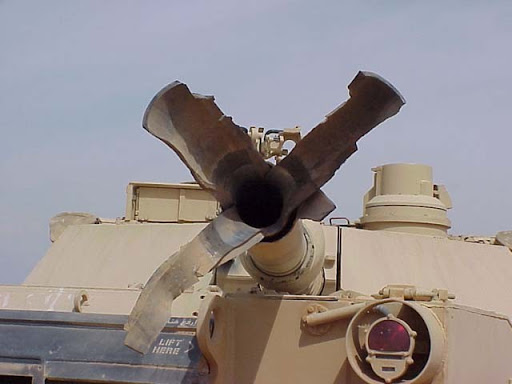

Careful with the beans...
Burst tank barrel.jpg (35.52 KiB) Viewed 3116 times
..but luckily it was pointing away from the wall.
