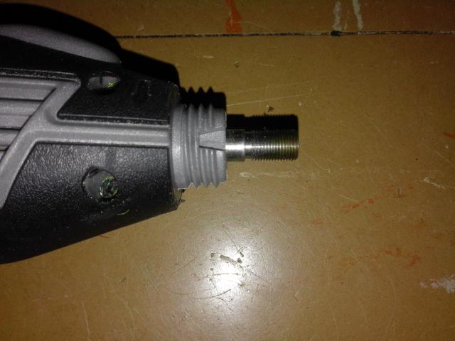

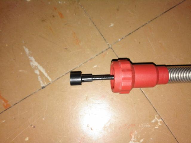

No -you take the chuck off. The chuck fits on a threaded drive shaft. There should be a flexible shaft inside the outer casing of the accessory. This should also have a threaded end which fits on the Dremel's drive shaft. The chrome end should screw direct on to the Dremel.
This shows the business end of my Dremel stripped down.
This shows the end of the flexible drive shaft, with corresponding threads.
As I said, this is from a different drill, and the thread for the shaft connections are incompatible.
