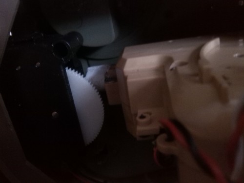

The barrel wouldn't go horizontal on full depression, so I have cut a short length of styrene tube, cut a slot down both sides and plugged it over the tab on the back of the airsoft unit. This will increase the movement range.

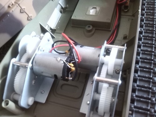

Which gearbox does it use? The low-profile, like the Jagdpanther? or the "normal" Engine-above-each-other? long shaft? short shaft?

Jagdpanther style, so low profile and long shaft eg 60mm.
The modification to the barrel elevation worked a treat, it now depresses to below horizontal.

Actually it was half a piece of tube in the end, just superglued onto the underside of the tab. Any old lump of styrene would do it, but I will throw a piece in the box and bring it to the meet for you.

Can you post a picture of what you did with the styrene tube to increase depression range ? Not getting a mental picture here at all.wibblywobbly wrote:I've got the Olive Drab but not the primer. I'll give it a try later and see what happens.

On the rear end of all HL airsoft and recoil units is a tab that sticks out, this tap rests on the curved part of the elevation unit. When the elevation unit rotates it pushes on the tab and raises and lowers the barrel.
On some tanks, and the T90 is one of them, the elevation unit can't push the tab high enough at its highest point to lower the barrel to horizontal. Think of a seesaw, the tip of the barrel is at one end, the mantlet hinge is in the middle, and the elevation unit is at the other end. If a short guy was stood under the seesaw he wouldn't be able to push his end up far enough to lower the other. (I am going to get arrested, I know I am - did I just say that??).
By putting a block under one end of the seesaw the guy can reach the underside and push it up further - oh God I just said it again....
