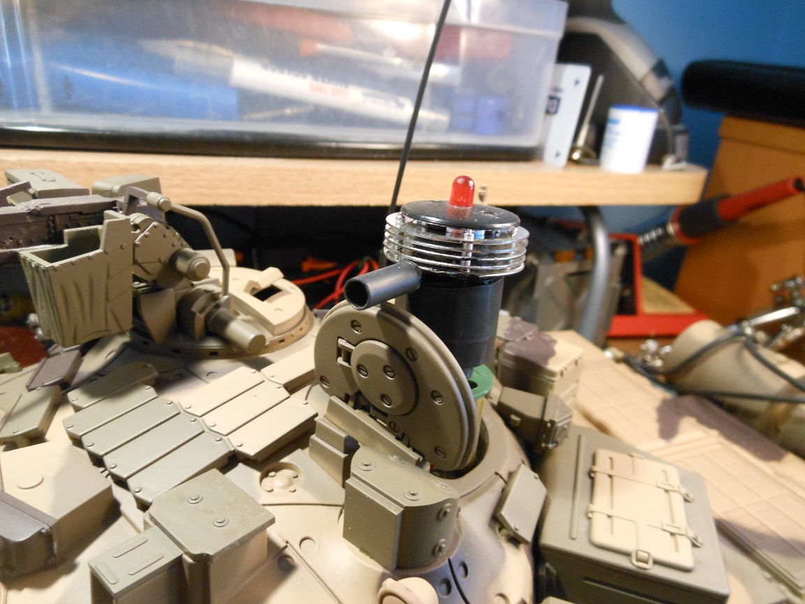

DIY battle unit using Heng Long unit, need to be raised to get over the forward facing hatch. Also attached IR emitter to the battle unit.

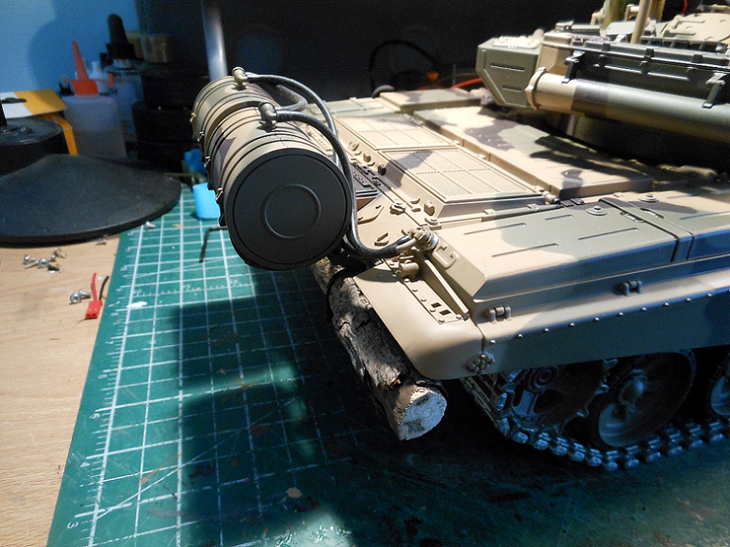

Use a magnet to hold the gas line as it needs to separate when you remove the top from the bottom. Found a stick for a log. They actually tell you to do that in the instructions.....  :-)

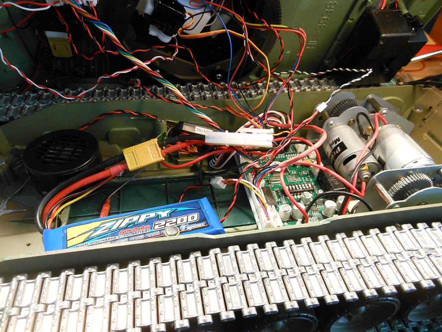

Replaced stock electronics with IBU2 Base using Chally sound set, 480 motors on the stock pot metal gearbox, removed battery compartment so lots of space.

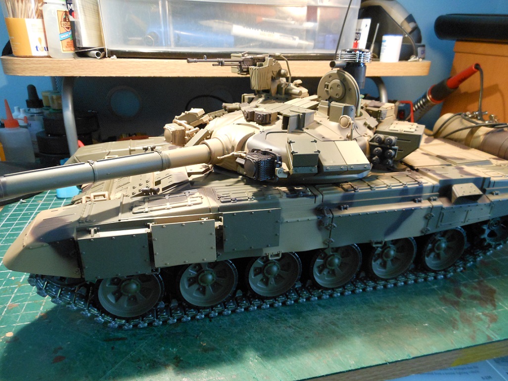

All exterior stock paint and parts. Put in a universal recoil unit from Clark.

is that Promax motors mounted on the gearboxes ?

Hi sir,its very very nice. Did u change the main receiver board ?And the motors ?The board that was in it is the hend long latest 2.4ghz system with 2 sounds ?

Promax 400 Long can which is the same as what we called 480s. Same size anyway.
I took out the very nice Heng Long Stock electronics (the dual sound set) and replaced it with IBU2 Base with Chally sound set.
